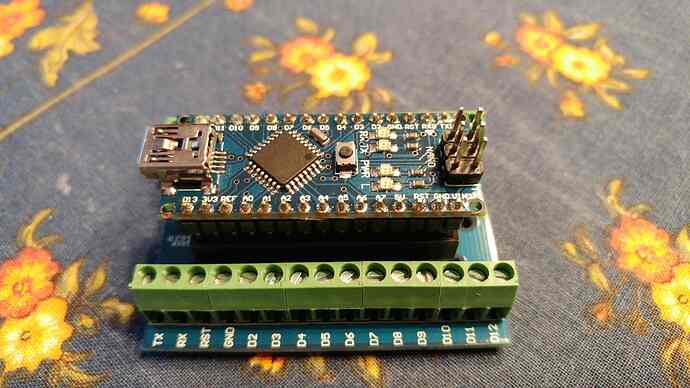

The NANO has all the compatibility of the UNO....less the size...
if you google breakout boards for Nano I'm sure you can find one similar to mine for less than 5$.
The breakout is very user friendly as you can see...
Or transfer the nano to a bread board for prototyping.
The biggest advantage is using a microUSB directly for programming...
Make sure you download the CH340 driver as some Chinese knockoffs use a CH340 chip (serial/usb) instead of the official FTDI chip...
Not a big issue...providing you have the drivers to work with the cheaper version of this Nano..
