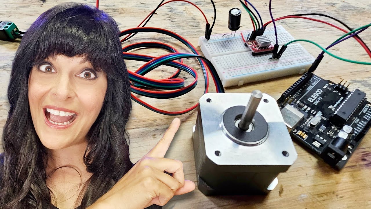

Ok, an interesting update. I watched this video, where this woman uses an a4988 driver to control a nema 17 stepper motor. She did a few things differently than I have:
  1. She connected the Reset and sleep pins directly to each other.
  2. She limited the potentiometer to 1.18 volts rather than the .28V i had done.
  3. She used this code:
const int dirPin = 7;
const int stepPin = 6;
  pinMode(dirPin, OUTPUT);
  pinMode(stepPin, OUTPUT);
  //pause before continuing with the program.
  delay(2000);
  //set stepper motor direction to clockwise
  digitalWrite(dirPin, LOW);
  //take one step
  digitalWrite(stepPin, HIGH);
  delayMicroseconds(3000);
  //pause before taking next step
  digitalWrite(stepPin, LOW);
I did these things, and it works. I think the main thing is the slp and rst pins. It only partially works without them, and is much smoother when they are connected to eachother.
Also, the code is much more simple.
