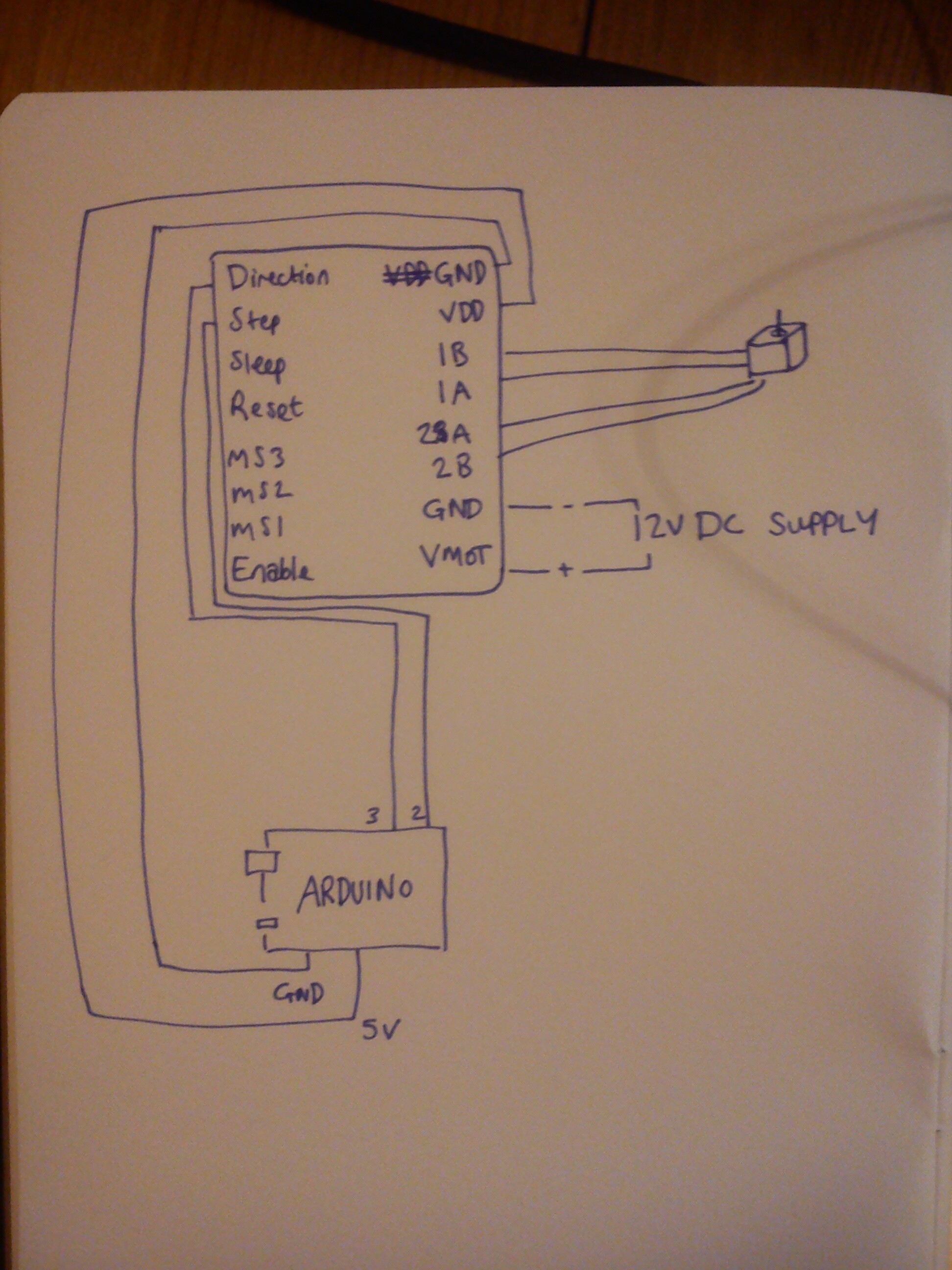

You will have to show us a diagram of how you have wired it (draw a sketch and take a photo of it?) and give details of the electronic hardware and software you are using.

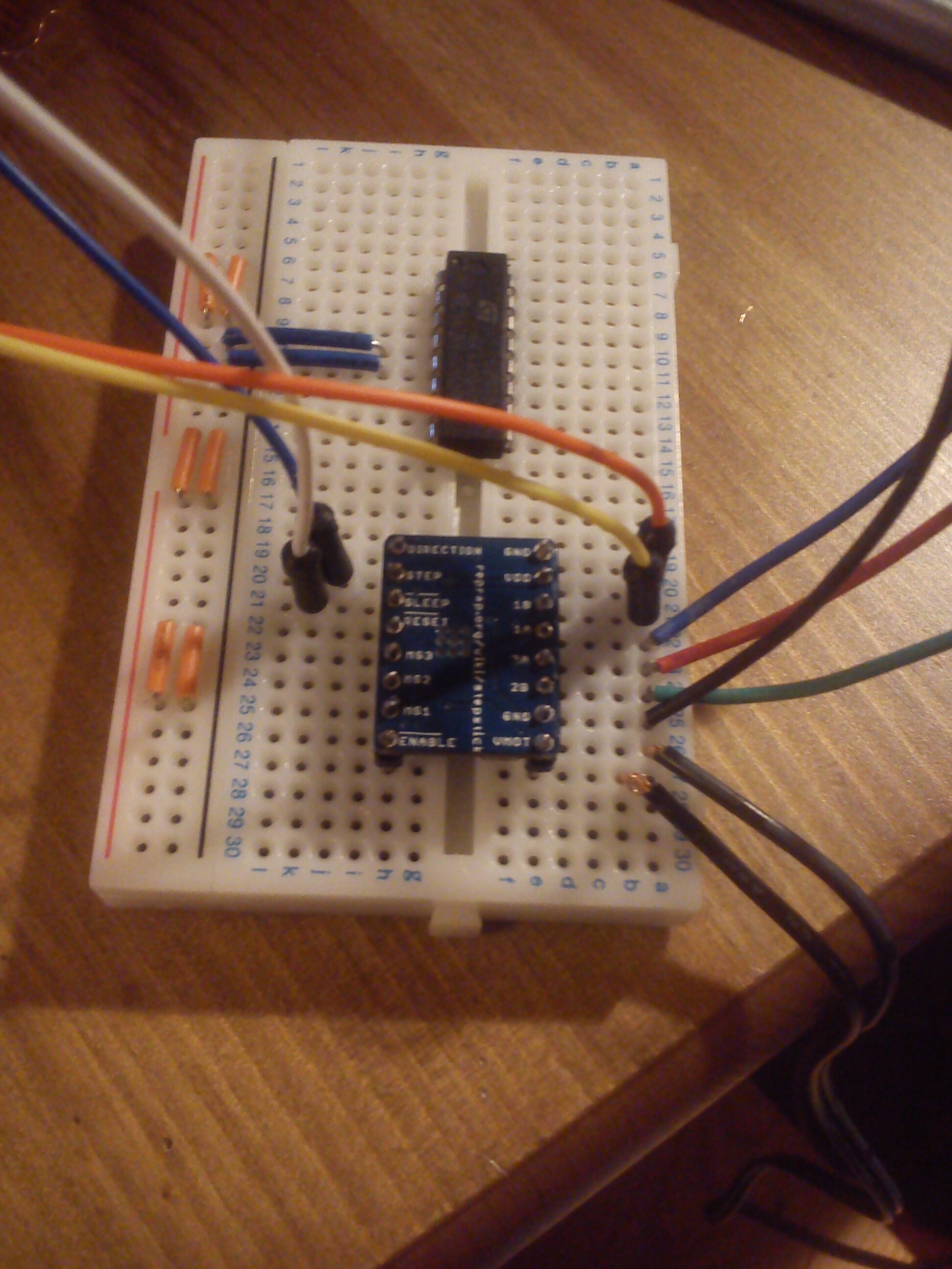

Hi so I got the A4988 today, I am trying to write some code for it, but I am not sure weather it is my code that is wrong or my wiring.
int turn = 2;
int dir = 3;
  pinMode(turn, OUTPUT);
  pinMode(dir, OUTPUT);
  digitalWrite(dir, HIGH);
  digitalWrite(turn, HIGH);
Should I be using enable?
Thanks.

so I have changed to code to
int turn = 2;
int dir = 3;
  delay(800);
  digitalWrite(turn, LOW);
  delay(800);
But still nothing, can you see what I am doing wrong?
Thanks
It looks from your diagram that you failed to connect /reset and sleep. A capacitor is strongly advised across the motor power supply, close to the driver board. Consult Pololu's recommended hookup at Pololu - A4988 Stepper Motor Driver Carrier, Black Edition
