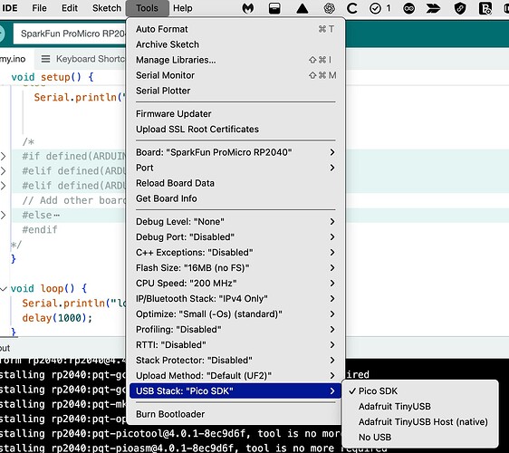

There is no such thing as an Arduino Pro Micro anymore, that board is now made by SparkFun in 3 flavours, an ESP32C3 which has no support for what you need, but the RP2040 and 2350 do have something, but you will be a lot better off with the AT
Here are the 3 Pro Micro boards
Here are the USB choices for the 2040 and 2350 (NOTE these are Raspberry Pi boards but supported under the Arduino IDE as well)

BTW, is your board a Mini or Micro? The Arduino Pro Mini is retired. Sparkfun makes Pro Micro in 3 flavours, esp32c3, rp2040 and rp2350. The last two are Pi boards.
