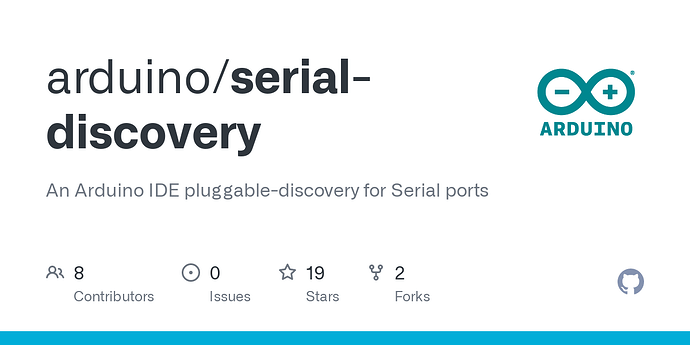

It does sound like something related to the way serial discovery is being handled. This is the standard tool used by Arduino IDE 2.x for that:
It is installed on your computer here:
C:\Users\Bob2\AppData\Local\Arduino15\packages\builtin\tools\serial-discovery\1.3.1
Some techniques that can be employed to troubleshoot serial discovery issues:
  • Open Windows Task Manager (Ctrl+Shift+Esc) and check under the "Arduino IDE" process tree to see if the serial-discovery.exe process is running.
  • Run serial-discovery.exe directly from the command line and send it commands as described here

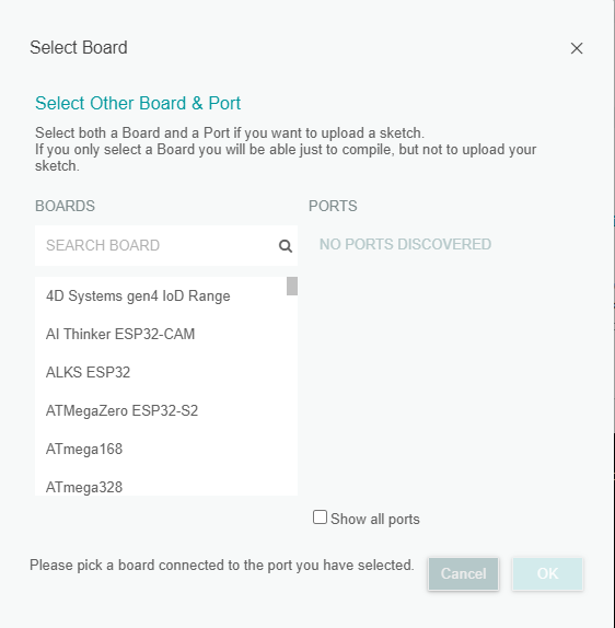

I have just had an instance of "NO PORTS DISCOVERED"
serial-discovery.exe is running, but not under the Arduino process tree
As to running serial-discoverry.exe, here is the output from the LIST command at the that no ports are visible in the IDE

So it seems that there are ports after all and the COM port numbers are what I would expect

No ports are visible after running this, but I must admit that I do not understand what I am doing with serial-discovery.exe and its output
As before, unplugging and of the boards that I have plugged in makes the remaining COM ports available immediately
