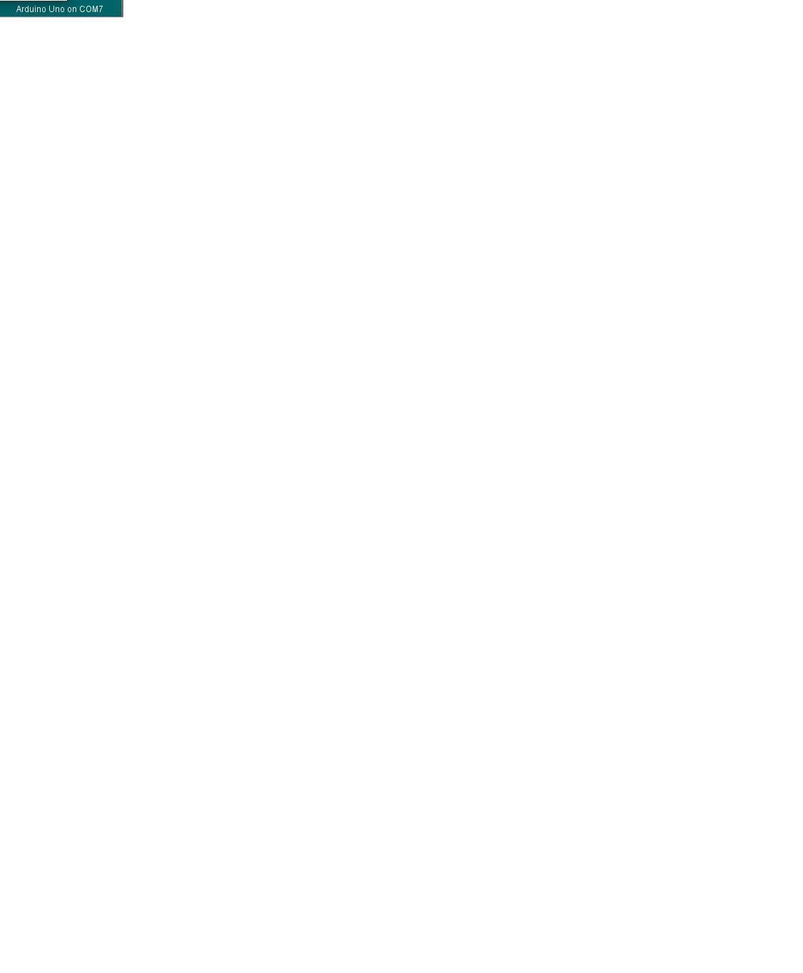

I tried your steps listed. In the first place, on the top menu Tools>Port, the Port option was grey off.
However, at the bottom right hand of the menu, the text "Arduino Uno on COM7".
This should mean that the board has recognised a com port.

No. It only means that you previously selected COM7 from the Tools > Port menu at some point. It will still show that even if there is no port COM7 on your computer.
