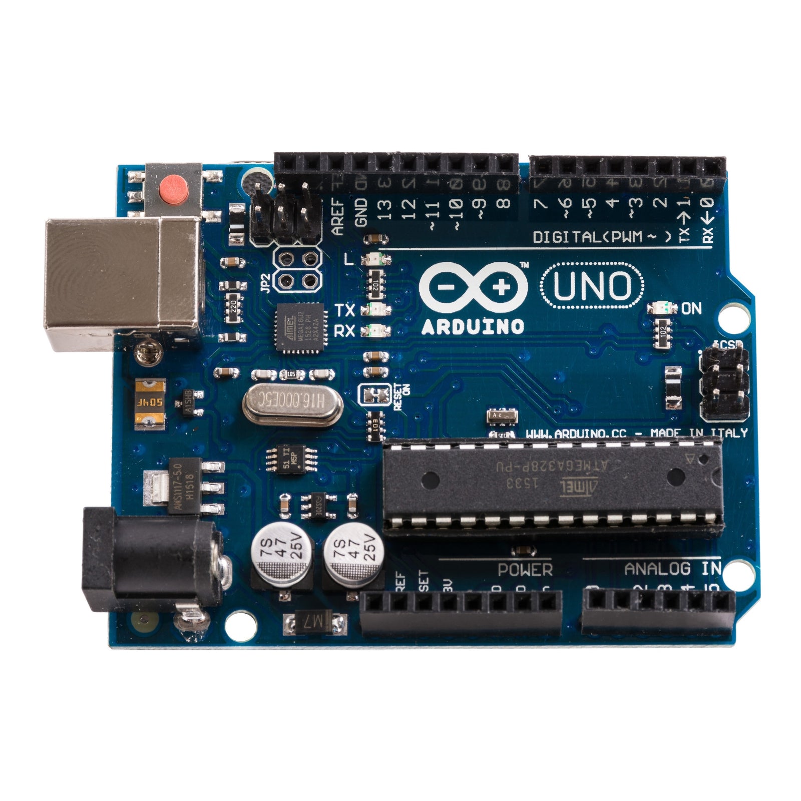

does your arduino look like this (1):
or this (2):
and are you coding it using the online ide or the arudino ide app for a computer,
its a nano clone and im using an app
wlcm
1:
or 2:

I've got the same problem with the Arduino Uno (2),
I've already checked the Com-Port in the settings which is correct.
And the funny thing is it works with the same port & cable with 1 Board but 5 other boards don't work.

So the second image of the arduino will not work with a chromebook or just the online editor at all, the first image has a small chip next to the rx and tx lights on the board, and what that chip does is let the online browser see it as a device it can use. You can use the second arduino board for the IDE that you install on your computer. But only the first image works with the online IDE.
It might well be so for Chromebook (I don't have access to one or any knowledge about using Arduino Cloud with Chrome OS machines), but for PCs using other operating systems there is no problem using the cheap derivative boards with a general purpose USB to serial bridge chip like the one shown in the second image you shared.
I'll provide instructions for configuring Arduino Cloud for use with that type of board:
  1. Start Arduino Create Agent if it is not already running.
  2. Open a sketch in Arduino Cloud Editor.
  3. Connect the board to your computer with a USB cable.
  4. Click "SELECT DEVICE" on the Cloud Editor toolbar.
    The "Select device" dialog will open.
  5. You will see the serial port of your board in the dialog, labeled "Unknown", click on it.
    The "Unknown Device Found" dialog will open.
  6. Search through the list of boards in the dialog until you find the name of your board (or of a functionally equivalent board, which in this example would be "Arduino Uno"). Click on it.
    The dialog will close.
You can now compile, upload and use Serial Monitor in Arduino Cloud Editor with your board.
