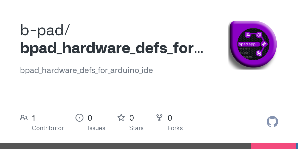

I'm trying to do this same thing right now and have made some progress. I've made a github repo that holds a json file for installing my custom board (based on an ESP32S3). Everything seems to be working except that I can't upload to my board after building. If I just append my boards.txt data to the end of the esp32 boards.txt everything works fine. My repo may help you, but I'm also looking for help on why uploading might not be working. The message I get is "Request 'upload' failed."

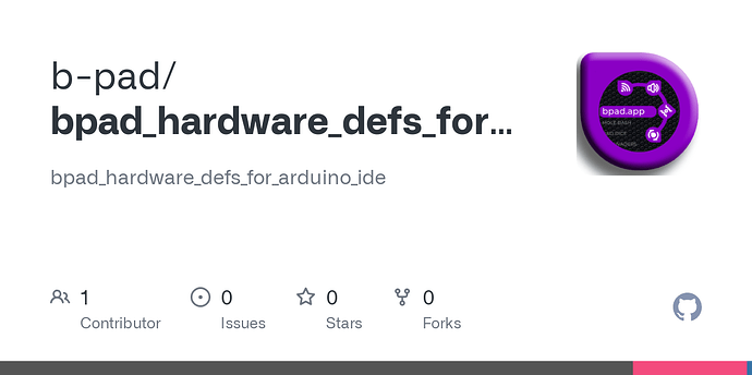

I actually got uploading working in LInux and pushed to the repo provided. However, my partner is on Windows and using the 1.8 IDE and its not working for him. This is his output:
