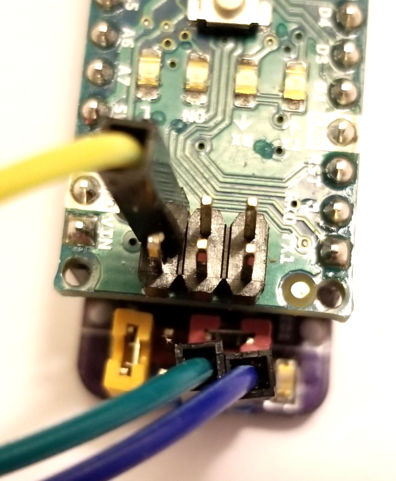

PS. the blue LED doesn't flash when I press the reset button.
No HV pulse :astonished:
Do you have the latest firmware installed, yellow jumper (WP) installed and red jumper installed on the red header on 2-pins closest to the blue LED?
If you do, then:
  • The blue LED should flash about 1 second after releasing the Nano's reset button.
  • It should also flash a few seconds after re-connecting the USB cable to the Nano.
  • Also just before programming starts.
    Jumper settings and connections :
Yellow = 5V, Green = GND, Blue = UPDI
EDIT: You need to remove the yellow jumper prior to updating the firmware.

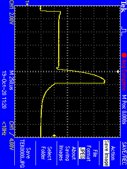

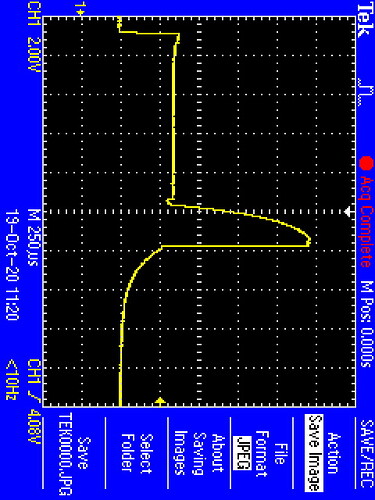

I amgoing tothrow a CRO onit and see if the HV pulse is there or not. maybe the LED has failed or something.
The HV pulse should look like this...
Yeah, I think you have / had a defective board. I'll send out a replacement tomorrow.
Thank you.
I finally got to take a snapshot of the UPDI pulse.
Sits at 2V, goes up to 5V for about 1ms then to 11.8 for 250us.
