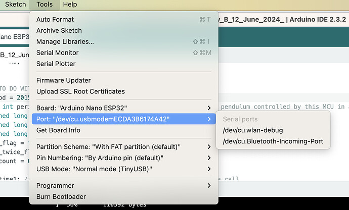

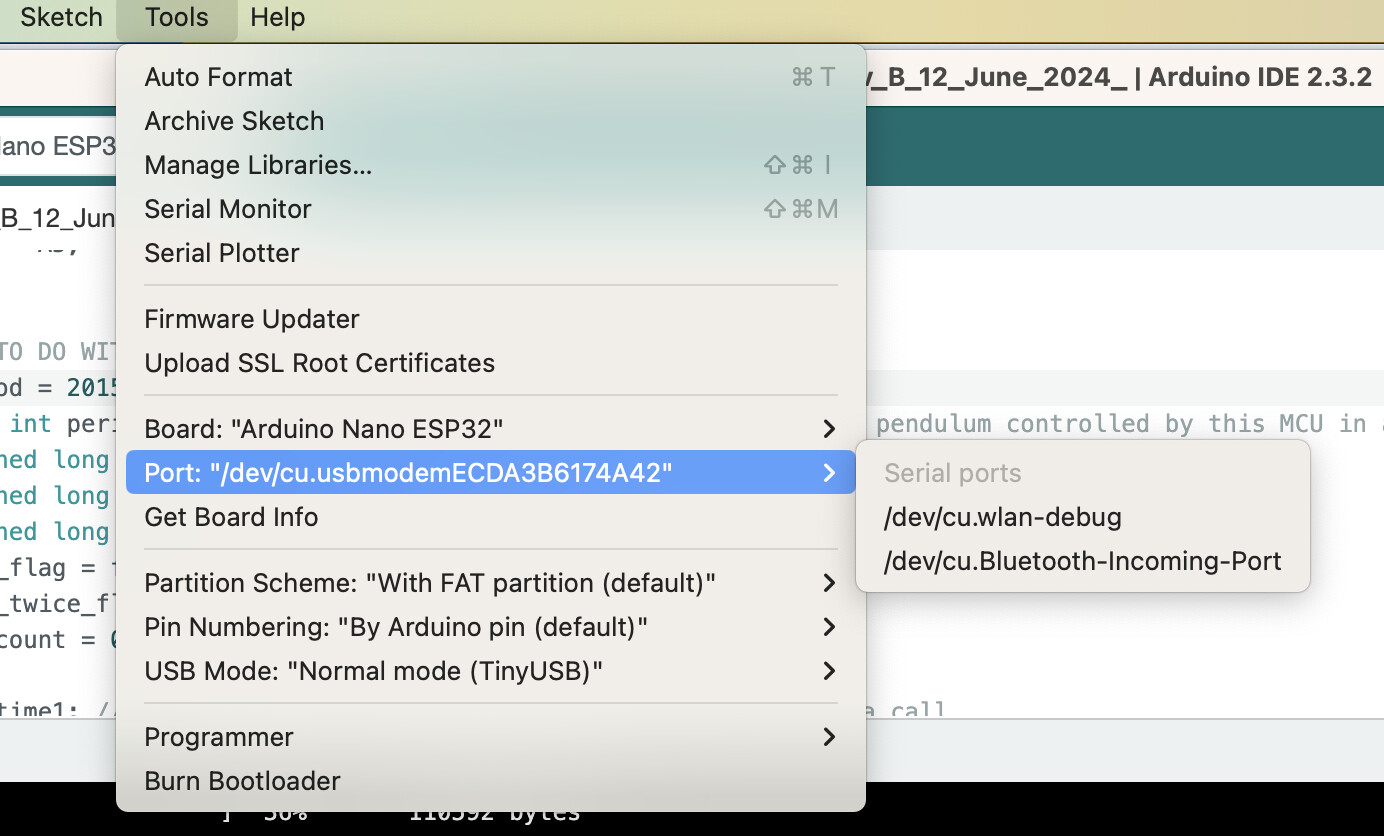

Sometimes the serial communication works just fine, but I often have a complete lack of connection and am unable to select the correct port, since no appropriate port is listed. When I remove the Arduino from my circuit (it is connected by inserting the header pins on the Nano board into a receptacle in my circuit) and try to establish connection, normal service is resumed.
This is how the ports listing looks when the problem manifests. The Mac seems to be aware of the port, but it is not listed as an option to choose.
