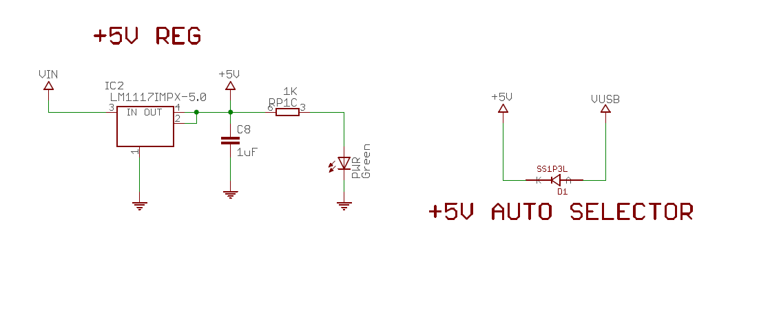

If you look at the schematic of the Nano at:
https://content.arduino.cc/assets/NanoV3.3_sch.pdf
Then you will see the following:
When the Nano is powered from the USB port alone, current flows through the diode D1, from VUSB to provide the +5V that powers the Nano.
When the Nano also has power going to VIN, then the voltage regulator will supply the +5V for the Nano. The diode prevents the +5V from going to the USB port.

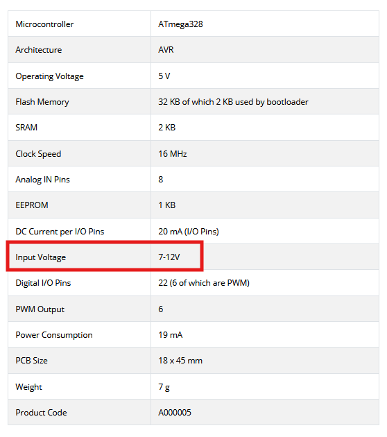

My question is; what is the highest Voltage that can be put into the Vin pin of the Nano before there can be potential problems with the Nano?
See the spec :wink: Arduino Nano — Arduino Official Store
Note that this is for an official Nano; clones might be different.
