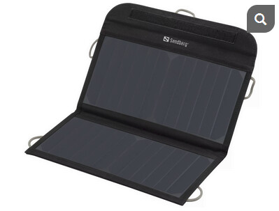

Hello, I have a 13W usb solar charger which was capable to output ~1A charge current during my recent afternoon tests. The problem with it, that it resets (output voltage drops to 0V) every 1-2 minutes for about 4 seconds (I measured the output voltage with a portable scope).

My problem is that, if I charge this power bank with the solar charger the % indication never increments, even after the USB tester measured 400-500mAh electric charge.
How is this possible? The power bank's charge electronics somehow gets tricked by the occasional 0V voltage drop?

I had one of those foldable photovoltaic collectors and it barely charged my phone (I was in a very sunny place). Another try for me with a "solar battery" would only charge its own battery to 50% (it would charge to 100% only on a USB tether). Batteries needs more than voltage potential. They need current flow that the panels might not supply. Good luck.
Makes sense, this is why I measured the current with an USB tester (and for a short test my diy Hall sensor based current tester). The current flows evenly (except for that 4sec voltage drop).
Can you post the solar charger part number or datasheet?
I have a solar cell that can sink current instead of sourcing it. I had to put a diode to prevent this...

Have you tested its output into a battery?
If it has a controller built in, then it may be expecting a battery to charge.
Do not expect the PV to power a device directly, I would say you need a storage device between it and any load.
Sandberg 420-40 pdf.
@TomGeorge: this is specifically an USB charger unit, should be compatible with any USB device. I'm not saying it does not work, beacuse it charges my phone for example (although a little annoying that the charging starts over every 1-2 minutes). My problem is that somehow the powerbank's % monitoring is not consistent with the delivered electric charge, when charged with this solar unit. :face_with_raised_eyebrow:
