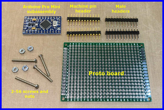

About your picture: did you solder those pin headers on the board? I can't see from the picture, but that approach makes me think maybe you only poked the headers through the holes on the board without soldering. If so, you aren't going to get reliable electrical connections and there is no guarantee the board was even reset.
No... I don't have a solder, I was hoping to use a breadboard. I do have a female-female wire I could try to attach though.
