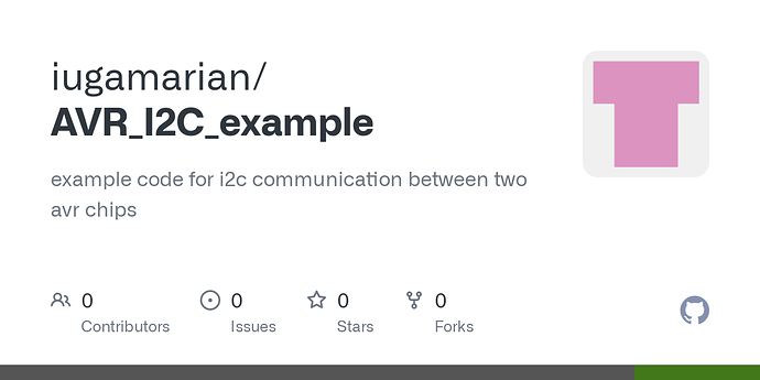

I have a small gift for Bill = bperrybap, for doing such good work:
An example of using i2c communication between two avr's,
with added test sound for buzzer on PB2 for atmega8.
Tested and works great !
a) the hex files are old - .c source needs recompiling
b) fuses are same as for USBasp, select F_CPU up in .c code
c) pull resistors 4.7k up required on sda and scl
d) search "makesnd" in the code to see where you can make modifications.

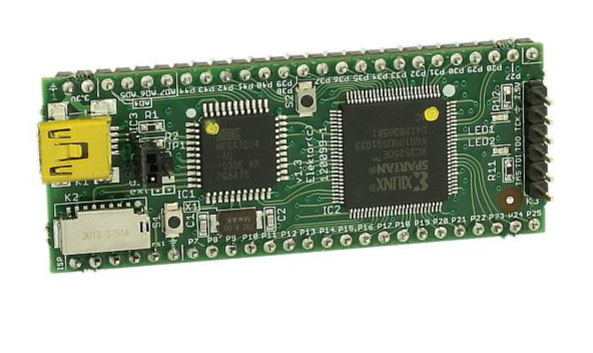

I own one of these Spartan FPGA boards:
This shows up as a removable drive and the bin file is sent to it. Notice the 32u4 MCU
oh yeah! lpc parts i work with have that capability. none of the complicated hardware and driver baloney. drag and drop is like heaven on earth.

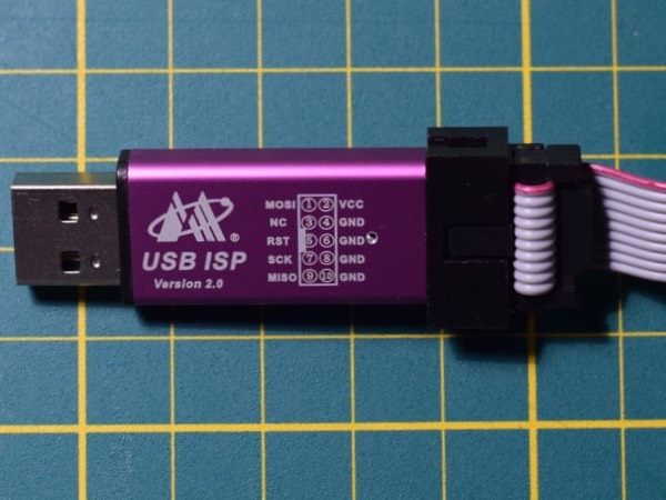

Great! Looking forward for a "clean" release of this. So, what's left? Anything I/we may help with?
BTW have you thought of supporting "different" USBasp hardware? Personally I prefer to use the USBISP hardware, because of its sleek hardware (picture down below). However, hardware-wise it's a tiny bit different compared to the "original" USBasp. A fork of the official USBasp firmware to add support for this hardware can be found here. Would love to use your FW with this hardware though!
There are some resources on the web describing how to make the Fischl fw work on this board. However I expect our firmware to work without modification (and we do have an atmega88 hex file). Can't try it out right now though.
The hardware difference seems to be that on this board USB D- is connected to both PB0 and PD3 (INT1). On the original usbasp, it is only connected to PB0. The original Fischl will not work as it drives (for no real reason) PD3 (It drives all PD pins except PD2). This makes usb communication impossible and actually causes pin contention.
Incidently, Bill (bperrybap) proactively fixed this: our fw only configures pins as output if they are really used as such.
Just for fun, I'll get such a board and try it out
