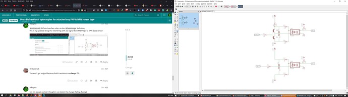

my design
It's fine to ignore my post. I have lots of other things to do. Good luck.
Which "bipolar" do you mean? Interface with bipolar transistors? How is that radically different from unipolar (MOS) interface? Your circuits remind me only on inverse logic, nothing bipolar.
Your circuits make me think that you lack basic knowledge about electronic circuits.
@DrDiettrich BiPolar Interface refers to the @TomGeorge definition,

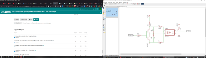

this is my updated design for interfering with any signal from PNP(High) or NPN (Low) sensor
You won't get a signal because both transistors are always ON.
yes it is always on, but I thought it can detect the change (Falling, Rasing)
but if it is not, what is the possible circuit to detect change?

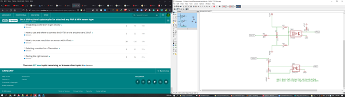

how about just changing the TTL from 12v to 3.3 and feeding to the normal opt and in software define to pull-up or pull-down depending on input sensor type
@TomGeorge @anon57585045 since have not gotten any solution for this idea I've changed my mind to used 4 pin connector instead of 3 pin connector, so if any sensor type plug in, then signal will be picked up by related circuits
or
