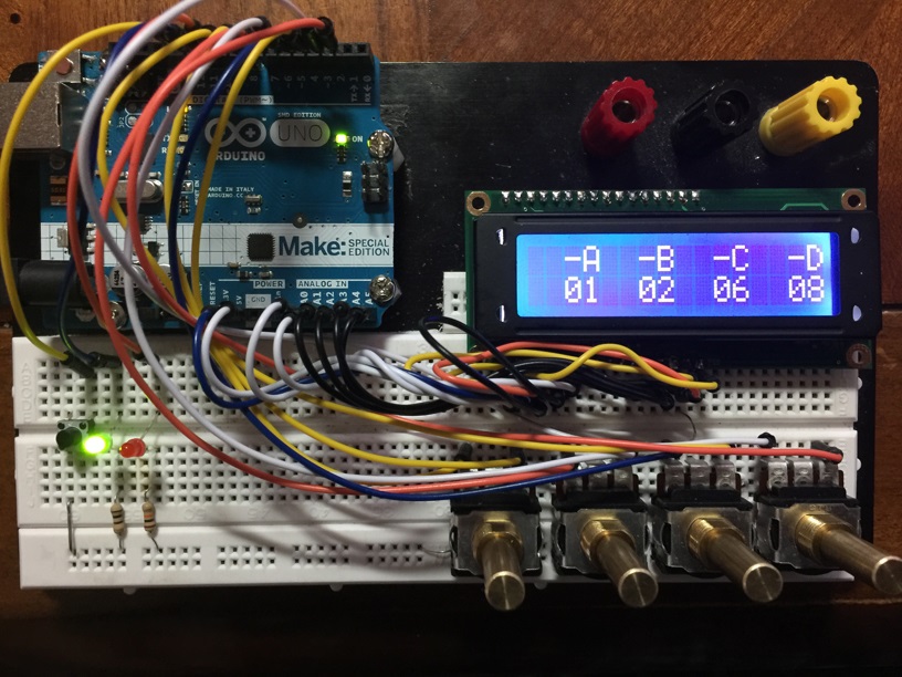

I can't tell from all the replies if you are wanting to use mult-position switches or rotary encoders or if it matters. The HTCL 2022 chip you suggested looks to be a Rotary "Decoder" so I stayed with that assumption. Out of curiosity I wired up four basic Quadrature rotary encoders with a 2x16 display, a push button and two LED's just to see if I could locate a suitable library and all of this would actually work with an UNO. I have attached a photo of the prototype showing a correct combination and a lit Green LED. This example uses all but pins 0,1 and 13. Basically dial in four numbers by rotating clockwise to increase the number or counter-clockwise to decrease the number. Then when the four numbers look right press the button. If they are the right 4-digit combination the green LED lights up and if not then the red LED lights up. Then the numbers reset to zero. I didn't use a schematic but will draw one if that would help. Any basic 3 pin quadrature rotary encoders should work. Just tie the common pins to ground. I think the ones I used were from CTS part# 288V232R161B2.
For reference, I used this encoder library from PaulStoffregen. GitHub - PaulStoffregen/Encoder: Quadrature Encoder Library for Arduino
Here is the code for the UNO if you want to try and build something like this and play around with it or expand on it.
/* Basic 4 rotary encoder combination lock */
#define RedLED 10
#define GrnLED 11
#define Button 12
#define DigitMaximum 99
#include <Encoder.h>
#include <LiquidCrystal.h>
// initialize the display library with the numbers of the interface pins
LiquidCrystal lcd(14, 15, 16, 17, 18, 19);  //Display on Analog Pins 14-19
// define an array of four encoders
Encoder RotaryEncoder[4] = {
  Encoder(9, 8),               //Rotary Encoder 1 on pins 9 and 8
  Encoder(7, 6),               //Rotary Encoder 2 on pins 7 and 6
  Encoder(5, 4),               //Rotary Encoder 3 on pins 5 and 4
  Encoder(3, 2)                //Rotary Encoder 4 on pins 3 and 2
int Combination[4] = {1, 2, 6, 8}; //Define 4 digit combination here
int oldPosition[4] = {1, 1, 1, 1}; //Start with 1's to allow initial display
  pinMode(RedLED, OUTPUT);
  pinMode(GrnLED, OUTPUT);
  pinMode(Button, INPUT_PULLUP);
  Serial.println("Basic Encoder Test:");
  lcd.begin(16, 2);
  lcd.print("  -A  -B  -C  -D");
  int newPosition;
  char numbers[17];
  bool changeFlag = 0;
  for (int i = 0; i < 4; ++i) {
    newPosition = RotaryEncoder[i].read();
    if (newPosition >= 0 && newPosition <= DigitMaximum && (newPosition != oldPosition[i])) {
      oldPosition[i] = newPosition;
      changeFlag = 1;
  //Read button and test combination if pressed
  if (digitalRead(Button) == LOW) {
    bool CorrectCombination = 1;
      if (oldPosition[i] != Combination[i]) CorrectCombination = 0;
    if (CorrectCombination) {
      digitalWrite(GrnLED, HIGH);   //Show Green if correct
      Serial.println("Correct Combination");
      digitalWrite(RedLED, HIGH);   //Show Red if incorrect
      Serial.println("Incorrrect Combination");
    delay(2000);
    while (digitalRead(Button) == LOW) {};         //Wait for button release
    digitalWrite(GrnLED, LOW);                     //Turn off LED's
    digitalWrite(RedLED, LOW);
    for (int i = 0; i < 4; ++i) {                  //Reset numbers to zero
      RotaryEncoder[i].write(0);
      oldPosition[i] = 0;
    changeFlag = 1;
  if (changeFlag) {   //Show new numbers if changed
    sprintf(numbers, "  %02d  %02d  %02d  %02d", oldPosition[0], oldPosition[1], oldPosition[2], oldPosition[3]);
    Serial.println(numbers);
    lcd.setCursor(0, 1);
    lcd.print(numbers);
    changeFlag = 0;
  delay(10);
