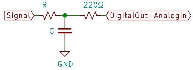

I have a circuit which reads an RC Voltage level via the A to D input, but I want to recharge the cap when the Voltage level drops below a set point.
Can I drive the A/D input high for a short time without configuring it as an output.

Not directly. You should use a FET and a separate output pin to switch the FET on/off.
Switching the A/D input to output creates the possibility of discharging the capacitor through the CMOS driver. This thus means you must carefully construct your external circuitry. It is possible but if you must ask, you should not attempt.

in another similar thread I suggested inserting a current limiting resistor

For faster charging (see post#9), you could use a current limiting resistor and temporarily configure the pin as an output to quickly charge or discharge the capacitor.
