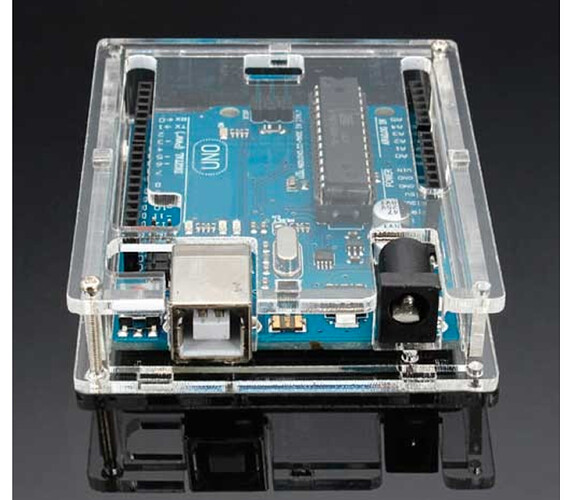

Well, using input pullup, it shouldn't see anything that results from a wire break; however, the other possibility is a loose wire occasionally shorting the pin to ground. I guess I have to ask, could you show us the bottom of the Arduino board?
This is probably a tangent, by the way, so feel free to not pursue, but I can't think of another cause.
Does the button have an LED inside it?
the arduino is in this case. Im guessing you are thinking it might short out on something its laying on? Or do you think a short on the arduino itself?
