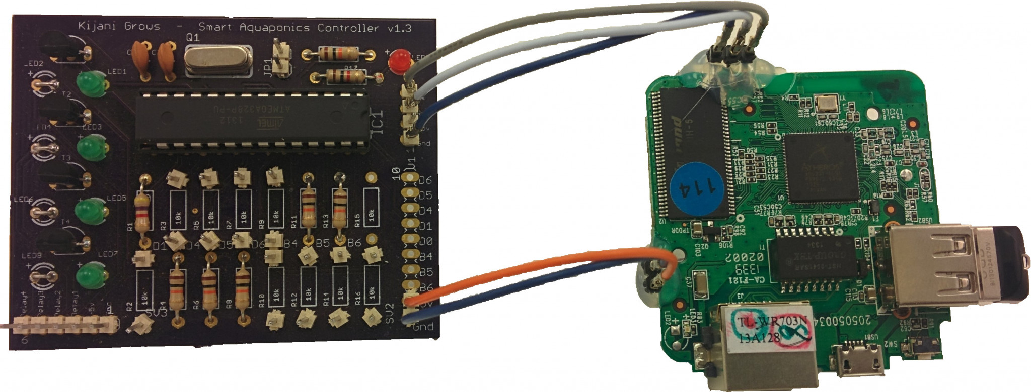

so after various versions e.g. v1, v1.1, v1.3 (shown below), v1.5

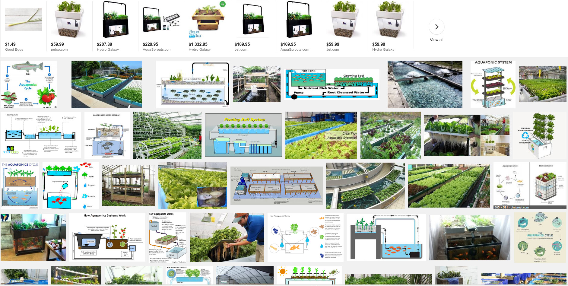

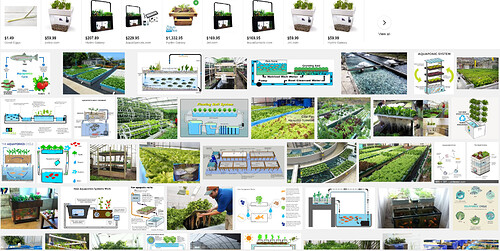

for instance this is what google search for aquaponics returns
which interestingly shows, my sketch diagram, a picture of my garden and 3 gardens straight from my door - without credits.
what the results show is that aquaponics is technology. so to automate this would be relatively easy as one can probably easily get sensors and shields for every component in such a system. the end result is a perfectly make project

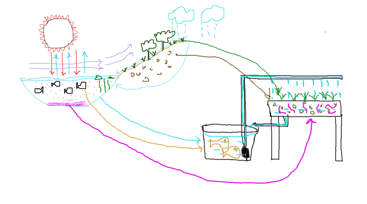

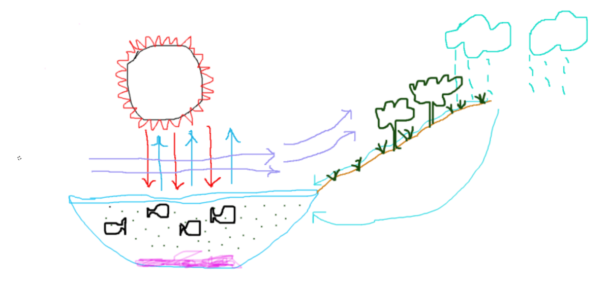

aquaponics mimics nature -is a better way of thinking about problems for physical applications that will eventually run and benefit from machine learning and AI. we need more basic abstractions to be able to model using hardware and software efficiently. i think a better way to visualize such a process is as shown below
from there it is very easy to move to here
and even easier to get here

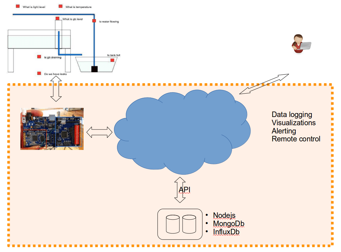

at this point really my concerns are what is digital, what is analogue and what is streaming with a timing of it's own - rather than questions like what sensors are good for aquaponics. the v2 controller works on the idea that the first 3 concerns will be the same for every physical project, whereas the last question will change for every application. it means data collection, communications, security layers can be the same for different applications whereas data analysis and presentation are different and can be done later in the chain.
traditionally, one connects a sensor, say temperature to a pin and writes code that ties that pin to that functionality. then you connect another sensor say a photocell to another pin and code that pin for a photocell. and you do the same for every peripheral on your board. combine the stack of hardware shield boards on the arduino above with software like this and you never have to spend another idle day depending on what you are trying to accomplish.
abstracting inputs into their basic forms also means that only raw data values are of interest rather than what they mean. so you can connect any sensor in any appropriate pin ie analogue sensors to any analogue pin, digital to any digital pin and streaming sensor to any of the streaming pins (1-wire, i2c, uart). streams are broken down into discrete values using the eol characters.
the default program on the atmega2560 polls the state of all pins and transmits these as a json string to the ar9331 soc running openwrt linux. the data is processed for any immediate action and the enriched data object is send to remote data servers for processing through the api.
a typical data object string is shown below
{"baudRate": 38400, "name": "manylabs", "uptime": "3 days, 3:26:08.680000", "pins": {"temperature_0": 69.69, "relay6": 0, "D38": 1, "D39": 1, "D36": 1, "D37": 1, "D34": 1, "D35": 1, "D32": 1, "D33": 1, "D30": 0, "D31": 0, "humidity_temperature": 18.0, "A15": 322.0, "A14": 284.0, "temperature_sensor_count": 1, "A11": 300.0, "A10": 258.0, "A13": 343.0, "A12": 340.0, "relay8": 0, "UART3": 0, "A1": 290.0, "A0": 330.0, "A3": 372.0, "A2": 348.0, "A5": 361.0, "A4": 360.0, "A7": 376.0, "A6": 384.0, "A9": 134.0, "A8": 375.0, "D29": 0, "D28": 0, "nutrientTemp": 20.94, "corizHumidity": 0.2, "D23": 0, "D22": 0, "D25": 1, "UART2": 0, "D49": 0, "D48": 0, "corizCo2": 2, "D43": 1, "D42": 0, "D41": 1, "D40": 1, "D47": 1, "D46": 0, "D45": 1, "D44": 1, "rtc": "2000/1/4 5:4:10", "humidity": 22.0, "flow_rate_sensor": 0.0, "D8": 1, "D9": 0, "D6": 1, "D7": 0, "D4": 1, "D5": 1, "D3": 0, "corizTemp": -99.8}, "version": "v2.0.0", "wlan0": "192.168.1.79", "initialize": 0, "atmegaUptime": "02:01:38:04"}

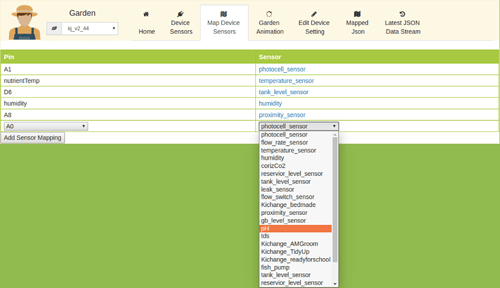

what remains is to tell the server which sensors are connected to which pins, so the useful data can be presented for visualization or further processing eg for alerts. that is the function of the kj2arduino library. this takes raw data, runs the appropriate methods against and returns the sensor data in human form - converted, units, icons, set points and other properties that go along with the sensor data
the process for mapping sensors is as easy as selecting your board, choosing the pin and selecting what things are connected to it using the api

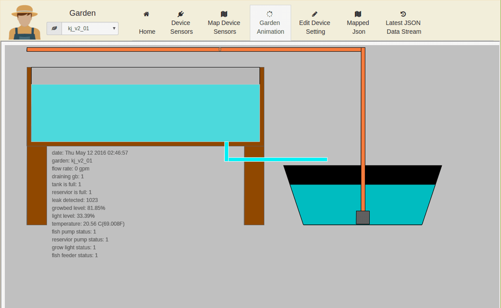

i just noticed that was the indoor irrigation system at many labs. if an aquaponic garden it can be further visualized as
or presented further as
