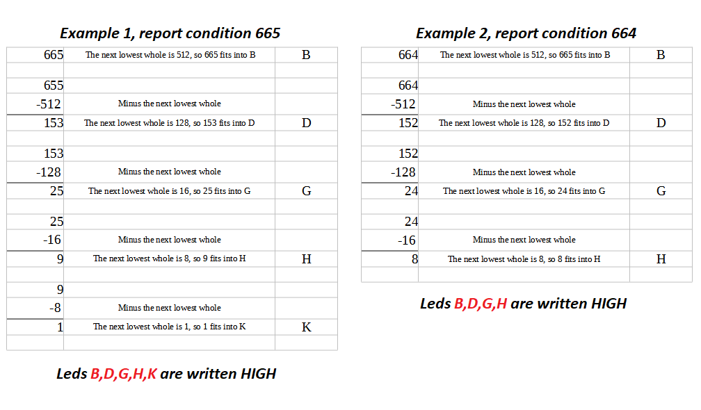

I’m using a Leonardo and have the need to report several hundred data points using optocouplers. Rather than using a single optocoupler per data point, I realized that I could do this using 11 otptocouplers along with a “digital-code” and thereby be able to report up to 1024 unique conditions.
Here is the layout:
The 11 LEDs: A, B, C, D, E, F, G, H, I, J, K
These correspond to the following numbers:
As an example, let’s say that the number 665 represented a condition that needed to be reported. So to report condition 665, the LEDs of optocouplers B,D,G,H,K would be written HIGH, and the remaining optocouplers LEDs would be written LOW. Here are a couple of examples showing how this works:
Unfortunately, my math skills have been under-used for a couple of decades. Is there an equation, whereby given the input of 665, the derivation of the corresponding LEDs could be calculated automatically? I’ve been looking at geometric series, but thus far the equations I have found don’t seem to be relevant for this objective. While the 1,2,4,8,16 etc is a geometric series, I’m not sure what the objective outlined above would be called.
From an Arduino code perspective, how would a function be designed so that the desired HIGH/LOW state of the 11 optocouplers LEDs could be passed to the function?

Sure. Does it have to pretty? If not, you can just test of the number is bigger than 1024, if so, subtract 1024, then check if it's bigger than 512, if so, subtract 512, etc. Basically recursively subtracting your numbers from large to small until your remainder ends up 0.
Notice that you can conveniently express your number series as 2^N (which is why you smartly picked those numbers anyway!)
Use bits inside an int.
Assigning the value will automatically set the bits, that can be tested and pushed to the optos.
That's far smarter & faster than my silly approach.
@anon35827816 I was trying to work it out on paper, but it was getting so cluttered, I couldn’t make any real progress.
@Whandall thanks for the suggestion. I am totally out of my depth on this. Would it be possible to give an example of how this is done?
Congratulations! You have invented BINARY.
