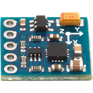

I am having an issue with my QMC5883L Magnetometer. I have tried various different example codes with their corresponding libraries, trying to get an x y z value. However all i see in my serial monitor is either X: 0 Y: 0 Z: 0 or X: -1 Y: -1 Z: -1.

Run the I2C address scanner program to test communications.

I got this:
I2C Scanner
Scanning...
I2C device found at address 0x1E !
done
so it seems to be connected
I think it does, i couldn't find a datasheet of my magnetometer but on the website i purchased it it says i can supply 3...5V.
1E is not the correct I2C address. The library you are using assumes a different one.
Ah yes i see what you mean. It seems to be using 0x0D. Is there a way to change this?
Of course you can change the library code to use a different I2C address, but the real question is: what sort of chip is on that board? Is it a magnetometer?

Alright i got it! Still very confused because apparently i have an hmc58853l and i thought that was the better one so no idea why i bought it labeled as qmc... i finally got it to work and only needed wire.h. Thanks a lot for your help!
