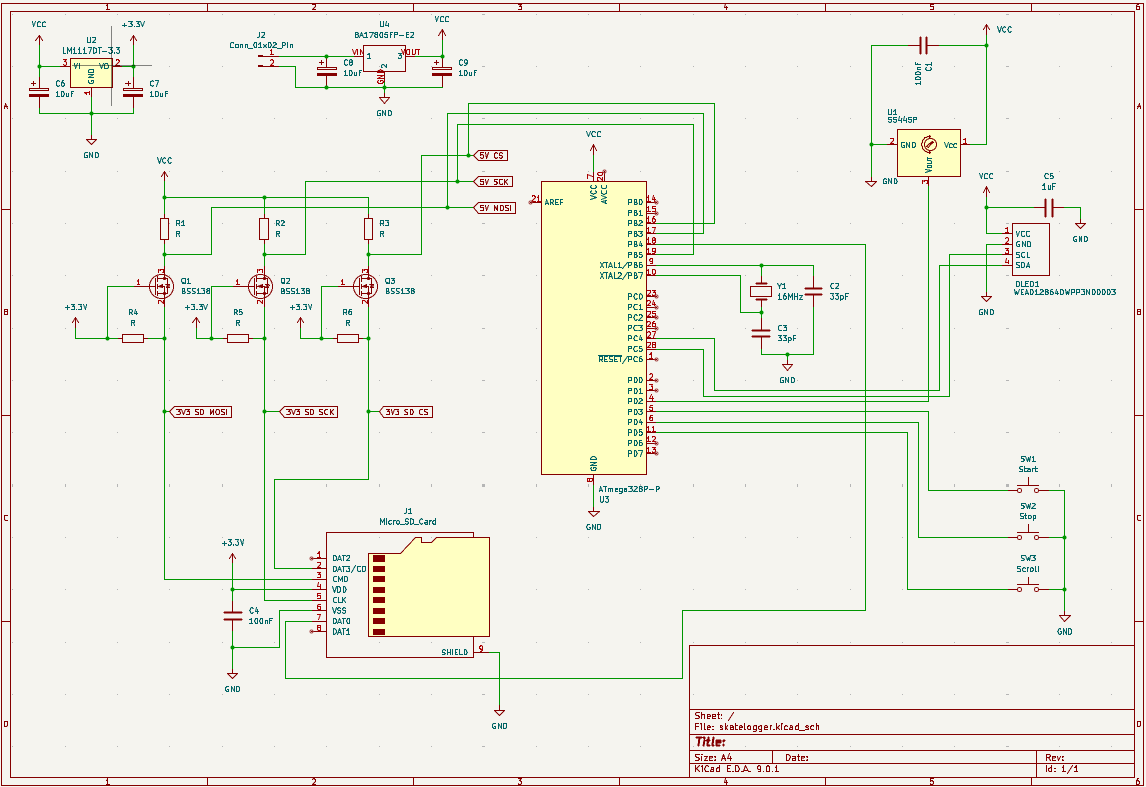

I am trying to get and WINSTAR OLED working together with a microSD card. I have test each parts separately and they work. But in combined together the OLED doesn't work I get the following error "OLED not found".
This is how I have wired the OLED and SD card to the UNO.

That sounds like a hardware problem, they are on different buses. What value of pull up resistors did you use. What does the scanner show? Posting an annotated schematic would help.
This is the schematic
R1,2,3,5,6,7 are all 10K's

Nice schematic, you do good work. The only problem I believe is there is you do not have pull up resistors on the I2C lines PC4(27) and PC5(28). Add 4.7K resistors from each of these pins to +5V. I will also recommend adding some high frequency bypass capacitors at the in and out of each regulator and each of the connectors.
After you add the resistors run the I2C scanner program and be sure it gives you the same port as you are using in your code.

It's not the problem, but for future reference, the level shifters you are using are bidirectional, but the three SPI lines are unidirectional. So you could just use a diode and a pullup resistor.
