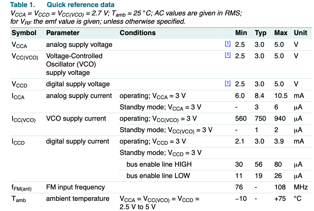

An easy way to turn a device on and off would be by powering it thru a pin. But I tried this with the TEA5767 and it doesn't really work. Supposedly we get 40ma per pin and the power requirement on the data sheet says the power requirement is much less than that.
What happens is the blue led on the board just goes dim. Can I connect 2 or 3 pins in parallel and turn them all on at once, would that help?

If you are drawing 17mA from an output pin the voltage will be lower than 5V. How much lower? You will have to measure it. Blue LEDs have a forward voltage drop of about 3.5V, so if the pin voltage falls to <4V under load, the LED will be dimmer, paralleling pins MIGHT work, but ? ?
Why not just put it in standby mode.
I will look into the standby mode, thank you. As to where the picture that I posted went, I don't see it either. Sorry for that.
