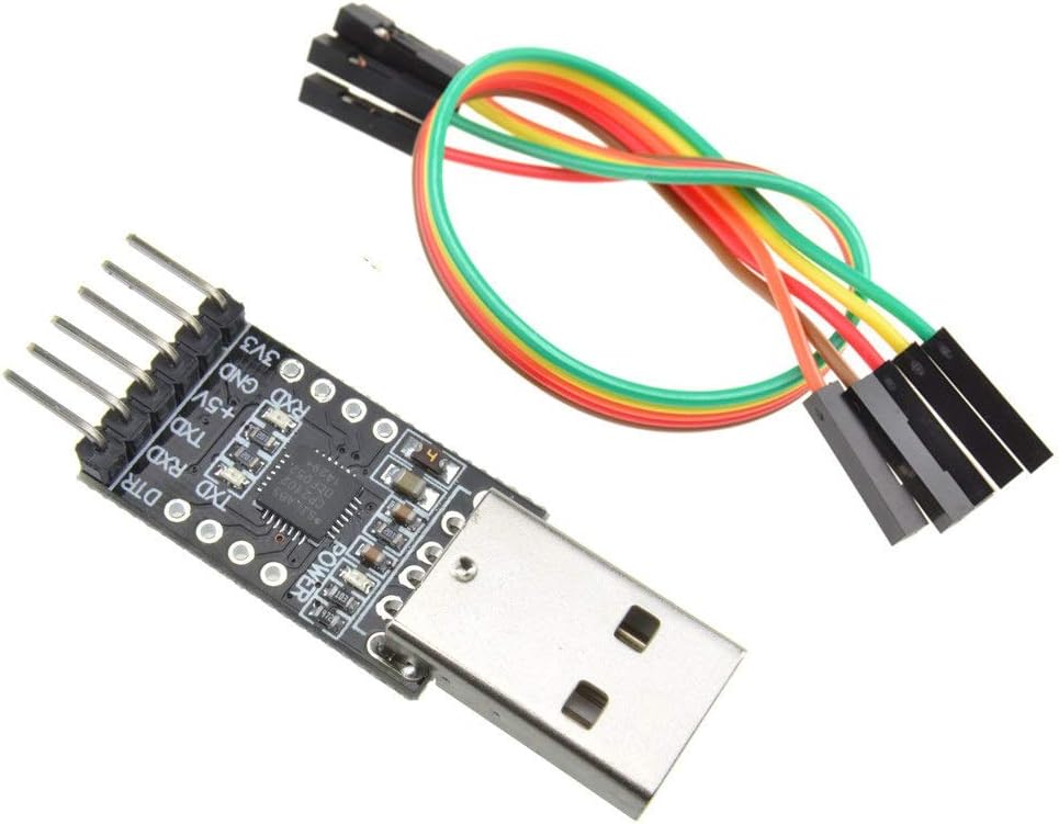

You need an external USB-UART converter, like this:
Connect it to arduino pins, on which you run a SoftwareSerial and read the data with Arduino Serial Monitor

Why doing it so complicate?????
Arduino -TTL , TTL - RS232, than RS232 to USB ???
Why not use standard USB-UART converter?
https://www.amazon.com/HiLetgo-FT232RL-Converter-Adapter-Breakout/dp/B00IJXZQ7C/

And what's the problem, It costs starting from two dollars ...
