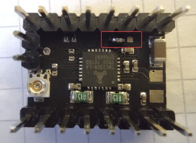

TL;DR:
  1. Modify the SilentStepperStick with the solder-blob (see picture)
  2. Make sure there's a 10k resistor between RX and TX signal from your MCU and connect both to UART pin of the SilentStepperStick.
  3. Use a known working example code. I recommend the one by @monkeyfist.
  4. Optionally connect with Watterott Configurator.

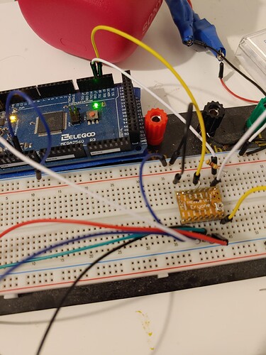

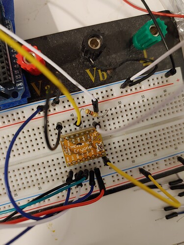

This post has been extremely useful. I am currently also working on a project with three TMC2209 SilentStepperModules.
The least I could do, is take some pictures of the solder-blob modification that is needed to get UART running.
I used a modified version of @monkeyfist's sketch from this post. What also helped me, was to connect the Watterott Configurator with a RS232 TTL to USB Converter. After that connection has been established, I was sure, that the hardware basically works.
@ceerious Wonderful connection technique using solder-blob!
I had to revisit this problem, and had a hard time getting it working again.
For reference for others, here is the code and wiring that I was able to get working to use the serial interface with the tmc2208. That's 2208, not 2209.
You have to solder the jumper pads as I described above.
DO NOT disconnect things while the 12 volts power supply is turned on, I fried one board by accident like that. Disconnecting the stepper while things are turned on will also fry the board.
code simplified
