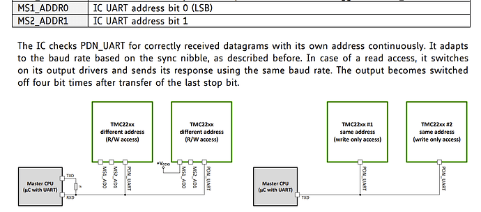

You use one UART port, and different addresses. This is where you set the address, and the address is defined via the MS1 & MS2 pins. You pull them either high or low to set the address.
#define DRIVER_ADDRESS 0b00 // TMC2209 Driver address according to MS1 and MS2
Here are instructions on how its defined:
You probably confused the library by having basically two instances of it running.

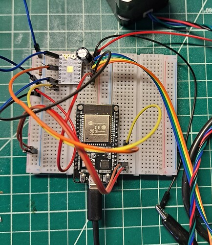

For the 2nd slave driver I connected MS1 to its own VIO and edited the top 15 lines and it works. Steps set correctly and the motors aren't running 4x under/4x over anymore.
I still need to use ESP.restart(). If I don't restart, the 4x faster/4x slower problem still exists. Also, the steps still won't set however, the steps for the last slave (0b01) do set correctly. So instead of last time where SERIAL1 wouldn't set the steps correctly, that problem moves to the first slave (0b00) not having the steps set correctly. I'm sure these are just personal observations/problems but they're happening :-/. Regardless, after ESP.restart() everything works fine.
I have a cheap 38pin "Inland" (Microcenter) devkit ("esp32dev" in platformio) and it always prints out garbage to SERIAL until I reset it, that seems to be the problem. The D1 Wemos ("wemos_d1_mini32") works fine however.
Thank you AGAIN!!!
The edited top 15 lines (the rest same as last post)

I did a bit of testing on the current draw, and i'm starting to think that the lab supply does show it correctly. I simply limited the current until the motor stalled, and really dialed in the current. There is no way it was drawing anything more than that, as the current was limited.
And the max current was what the supply had shown as the max current draw.
@monkeyfist
That's my theory. The way I see it is that if the display on the supply was clipping, then the hold current wouldn't be displayed so consistently.
Maybe you could give a small write up sometime on the other driver options. I've read about all of them in the datasheet and most of them seem worth wild but I'm not 100% confident I'm using them correctly. Also, the advice to use the RTOS features seems extremely wise. I tried your code containing the RTOS apis but I'm not sure it ran correctly. Do forward declarations mess with the ESP32 RTOS? I had to put 3 above setup to get it to compile, but the motors ran erratically (or maybe that was the desired effect :-/). Either way, as you suggest, I'm going to start using the RTOS features.

Just curious, in the image shown, is the GND connection wrong on the ESP32?

Hi all!
I try to setup and use three TMC 2209 v3.1 with an ESP32 DevKitC controller.
Long story short: if i connect only one TMCs UART pin to ESP32 it works and i can change the microsteps and control speed and direction via VACTUAL command. But if i connect all the three TMC UART pins to ESP32 then nothing happens not a move and the serial monitor always report 256 microsteps (i know it's the sign that the ESP32 is not communicating with TMCs)
The connection cable is a cable with 1K resistor like in this video at 0:12 : Setting up TMC2209 in UART mode on MRR ESPA (Marlin 2.0 + ESP3D on ESP32) - YouTube
I Think it's not software error, but i need help to figure out what should i do to make it work with three TMCs.
Can you please help me figure out whats happening?
Thank you very much for every idea!
If you are running 3 drivers on single UART, you need to set different addresses for them via the MS1 & MS2 pins. And then set up individual instances of TMCstepper for all the drivers.
#define DRIVER_ADDRESS 0b00 Addresses 0-3 are available.
TMC2209Stepper driver(&SERIAL_PORT, R_SENSE, DRIVER_ADDRESS);
You can have upto 4 drivers on single UART, in binary after the 0b. So 00, 01, 10, 11 based on the MS1 & MS2.
https://www.trinamic.com/fileadmin/assets/Products/ICs_Documents/TMC2209_Datasheet_V103.pdf
Thank you for the answer!
I set up the address via MS1 MS2 switches, if i try the arduino program with 0b00 or 0b01 it works with the addressed driver.
My problem is when i connect the above linked three way UART wire to more than one TMC the UART brakes and nothing works after.
I use this board for the TMCs, don't know maybe this is a source of the problem?
modul-stepper-driver-2
