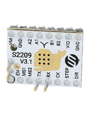

Sorry for the confusion. So step by step:
  • 3 TMC2209 connected to the ESP32 with STEP/DIR wire
  • 3 enable wire connected to ESP32 GND
  • 3 TMC2209 connected to motor power and motors connected too
  • while this above linked board need it, all three boards connected to 5V/GND (RED/BLACK pins on the board image)
  • 3 TMC2209 TX pin linked and connected to ESP32 GPIO16/17 with the 1K resistor between TX-RX
If i switch on the power button the motor power and the 5V to the black board comes on, and after a few seconds i connect the ESP32 to the computer. It's powered from the USB port.

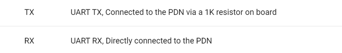

Unless there are some extra components on those boards, there are some resistors there.. don't know why. Maybe you should measure if there is some extra resistors on that UART pin.
"TMC2209 TX pin" There is no TX pin on those drivers, the two UART pins are the same.
I check the board and resistance tomorrow. I tried to the simplest solution to use three TMC with an ESP32, but it ended up a long building process.
I know that TX RX are the same on this TMC2209 but the TX characters printed near to the pin that i connected to the ESP this is why wrote TX pin.
This is what i have:
That's how it always is, there is always some small mistake somewhere.
Maybe its exactly because these driver boards have the 1k resistor onboard? So you have two resistors... that's why it has TX and RX outputs. That struck to me as odd, why would it have TX & RX markings when on most driver boards its just single PDN output.
So you should use the RX pin that does not have the resistor for single wire UART.
This is really confusing but i check it out tomorrow if i have time! Thank you very very much! i hope this is the solution.
If i connect the second and third TMC2209 the resistance is not 1K but much more and the UART breaks?
So i need the wire i have with 1K resistor but to RX on all three TMC2209 and not the TX pin, if i good understand. Or can i use a simple wire without resistor if i use the TX pin, what do you think?
Not easy to understand these motor drivers, every new version is different a little or more, so you have to pay close attention what wire goes where.
Yes, just connect all drivers using the RX pin, single wire.
And you have the 1k resistor on the ESP32, just like you said:
"ESP32 GPIO16/17 with the 1K resistor between TX-RX"
This is the single wire UART.
The issue was just that you had a bit uncommon driver board with an extra feature on it.

One thing i was wondering is why did you mention you are using 5v on the VIO?
If you are using 5v logic voltage, it tries to communicate using 5v UART signal. You need to use 3.3v logic voltage. ESP32 is 3.3v logic, never mix 5v logic with 3.3v logic. It might actually fry the UART inputs in the worst case. But the main problem is that the ESP32 speaks at 3.3v and the TMC2209 speaks in 5v. So its a mismatch.
"* while this above linked board need it, all three boards connected to 5V/GND (RED/BLACK pins on the board image)"
This might cause your issues in UART acting weird. I missed this yesterday, was a bit tired.
If switching to 3.3v does not help, you should try using pull up resistors on the UART, i think 10k-100k resistors from 3.3.v to UART TX & RX.
EDIT : Also, take the 3.3v power from the ESP32 dev board. As the UART also needs the ground connection. Im just saying this because you mentioned that you first power the motor & driver logic and then the ESP32. So it seemed that you are not taking the logic power from the ESP32 board. There needs to be a ground connection between the ESP32 & the driver boards.
EDIT: It works!! Changed the logic voltage to 3.3V (from ESP32) and all the three TMC2209 moves with the above test code flawlessly! Thank you very much for your help, I would never have figured this out without you! Now I can work on the program because the communication between the devices is already working.
Thank you again for the detailed help and infos!!

// Yes ESP32cam with second serial port, using 3.1 driver and one wire via 1k resister. No dir / step pins connected.
