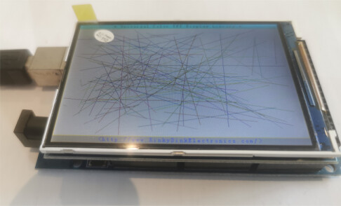

photo of a mcufried_3_5_TFT_LCD plugged into a Mega running File>Examples>MCUFRIEND_kbv>GLUE_Demo_480x320 from the MCUFRIEND_kbv library
