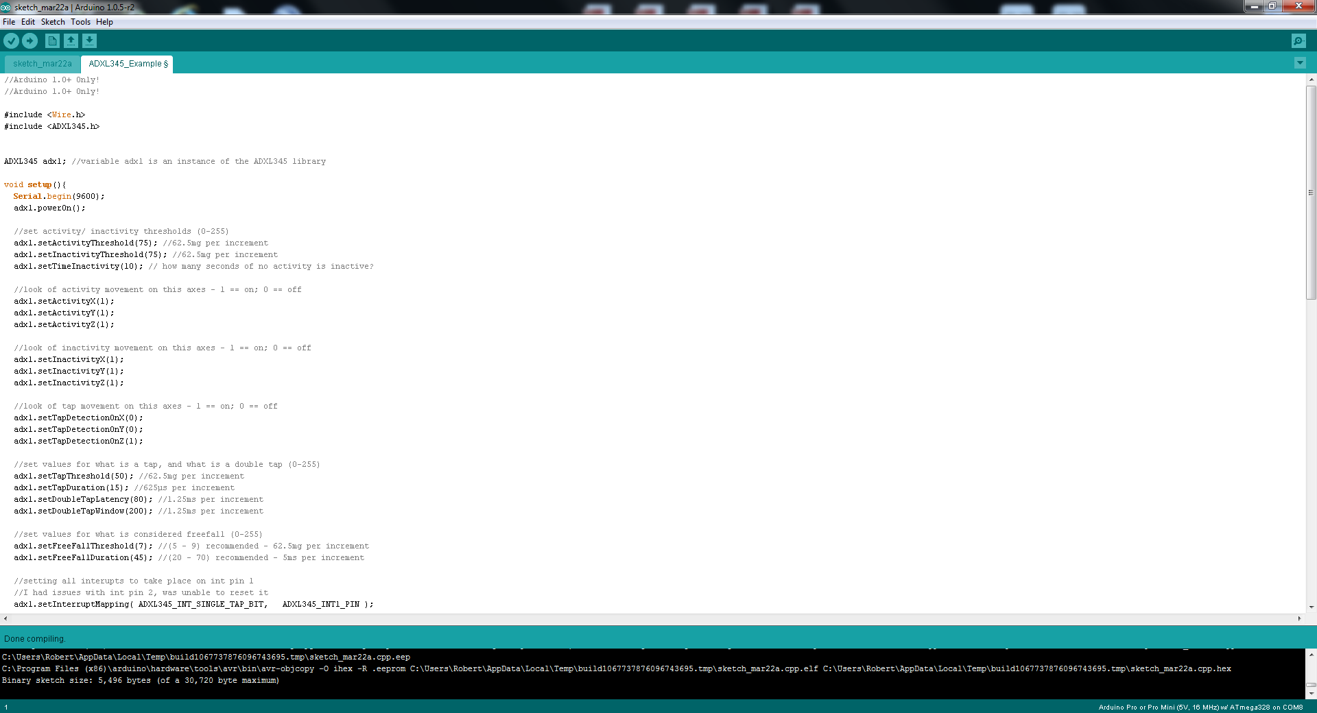

I was just try to follow the tutorial here:
http://bildr.org/2011/03/adxl345-arduino/
I tried uploading the code they were using but was getting tons of errors. I don't know where to start with that.

I figured out why it wouldn't compile.
You don't need IDE 1.0 , You just need 1.0+ (higher than 1.0) so 1.05 is fine.
On the Bildr page there is a button on the left labeled "download".
Click that to download the zip file. (delete any files you had previously installed for this library first)
Install it in the My documents\Arduino\Libraries folder.
Rename the folder to ADXL345 (get rid of the arduino v6 part)
Close all instances of the IDE.
Reopen IDE and click Sketch\add file and select the ADXL345_Example.ino
It should compile with IDE 1.05

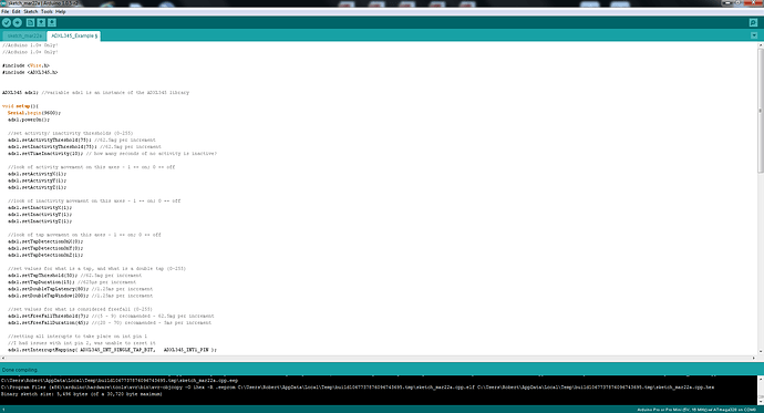

These are the errors I get when I click the upload button:
ADXL345_Example:10: error: 'ADXL345' does not name a type
ADXL345_Example.ino: In function 'void setup()':
ADXL345_Example:14: error: 'adxl' was not declared in this scope
ADXL345_Example:48: error: 'ADXL345_INT_SINGLE_TAP_BIT' was not declared in this scope
ADXL345_Example:48: error: 'ADXL345_INT1_PIN' was not declared in this scope
ADXL345_Example:49: error: 'ADXL345_INT_DOUBLE_TAP_BIT' was not declared in this scope
ADXL345_Example:50: error: 'ADXL345_INT_FREE_FALL_BIT' was not declared in this scope
ADXL345_Example:51: error: 'ADXL345_INT_ACTIVITY_BIT' was not declared in this scope
ADXL345_Example:52: error: 'ADXL345_INT_INACTIVITY_BIT' was not declared in this scope
ADXL345_Example.ino: In function 'void loop()':
ADXL345_Example:66: error: 'adxl' was not declared in this scope
ADXL345_Example:82: error: 'ADXL345_FREE_FALL' was not declared in this scope
ADXL345_Example:88: error: 'ADXL345_INACTIVITY' was not declared in this scope
ADXL345_Example:94: error: 'ADXL345_ACTIVITY' was not declared in this scope
ADXL345_Example:100: error: 'ADXL345_DOUBLE_TAP' was not declared in this scope
ADXL345_Example:106: error: 'ADXL345_SINGLE_TAP' was not declared in this scope
Kind of confused about the IDE part. I believe I downloaded 1.0.5. On the top of the IDE it says 1.0.5-r2
I downloaded the zip file and put it in the folder you specified
The library zip file creates TWO FOLDERS NAMED ADXL3145.
THE EXAMPLE IS IN THIS FOLDER . THIS IS WRONG.
THE FILES IN THE SECOND FOLDER MUST BE MOVED (from the folder named ADXL345) TO THE FOLDER YOU RENAMED
and then the empty folder named ADXL345 SHOULD BE DELETED. THEN CLOSE ALL INSTANCES OF THE IDE and reopen it.
THE FIRST ONE IS THE ONE WITH THE NAME: "ADXL345(Arduino)[V6]" (THIS IS THE ONE YOU RENAME)
Check the files to make sure that your file tree is as follows:
Library folder : name: ADXL345
FOLDER CONTENTS:
file : ADXL345.cpp
file: ADXL345.H
file: License.txt (don't know if this is important)
file: Read_Me.txt (this one not critical)
subdirectory folder : Example You have to create this folder in the folder you renamed and move the file named ADXL_Example.ino into the folder you just created named Example.
The file tree when correct should be as follows.
contents: file: ADXL_Example.ino (file date 2/19/2012 timestamp:6:44pm filesize 4kb)
see attached screenshot of library folder contents.
Make sure there are NOT TWO folders named ADXL345.
Make sure that the example is in the subdirectory below the library file.
Take some screenshots of the filetree . are the dates and times the same as in my screenshot ?
Did you open it using sketch\add file ?
I got lots of errors until I discovered the download button on the left .
Check my last post. I modified it. read carefully.
Worked this time. Thanks. I think I have a little bit of a hard time following you but I am trying my best. Going to see if I can figure out some things now.
