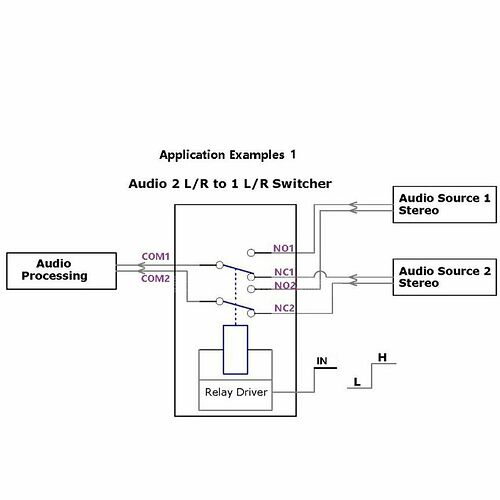

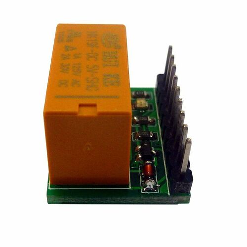

Easiest way would be relays. Then you don't have to worry about the analog signals. If you can find some dpdt relay modules, that would make things easier because you can switch the outgoing and incoming audio channels together. For 3 "channels", 2 such relays would be needed.
Like this one for example.
Or a couple of these
Instead of L and R you would have outgoing and incoming audio.

if i wanted to directly connect 2 headsets then ie the mic from headset 1 to the headphone of headset 2 would i also need to use an audio amplifier too?
georgegohl888:
Thanks for the help!
I'd equip each mic with a small pre-amp for decent volume and quality.
Or you can place pre-amps at the headphones jack... but in such case the loud CLICK when switching the stations shall also be amplified - making usage a bit annoying.
preamps at the mic amplify the mic output. preamps at the headphone amplify what is left of the mic signal after resistance, capacitive and induction effects, and amplify any noise induced along the way
amplify audio and video at the source where possible.
