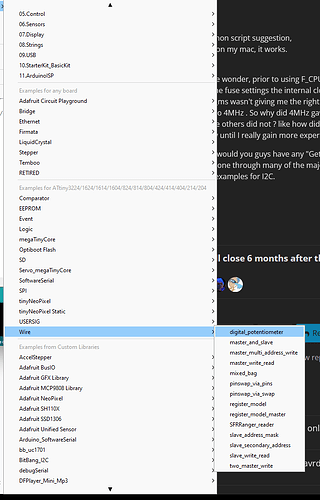

Wire examples are part of Megatinycore
Not really with the Arduino.
