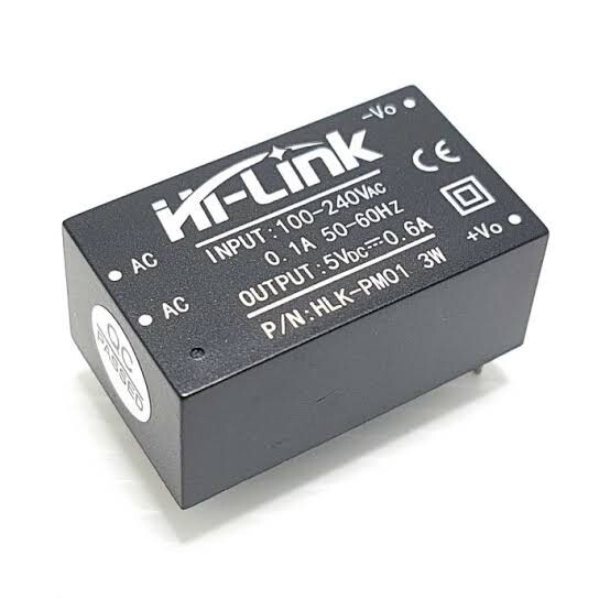

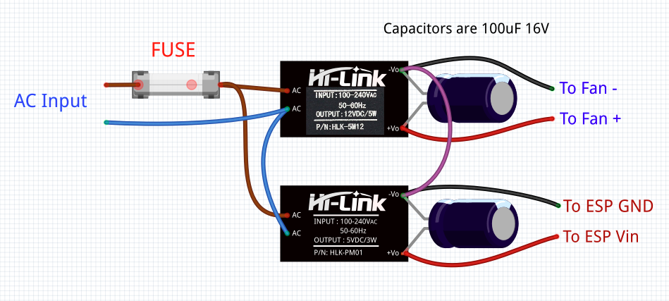

I have this to power the fan and the mcu, but I'm not really sure how to connect them since fan needs 12v and esp8266 and the sensor needs 5v.
