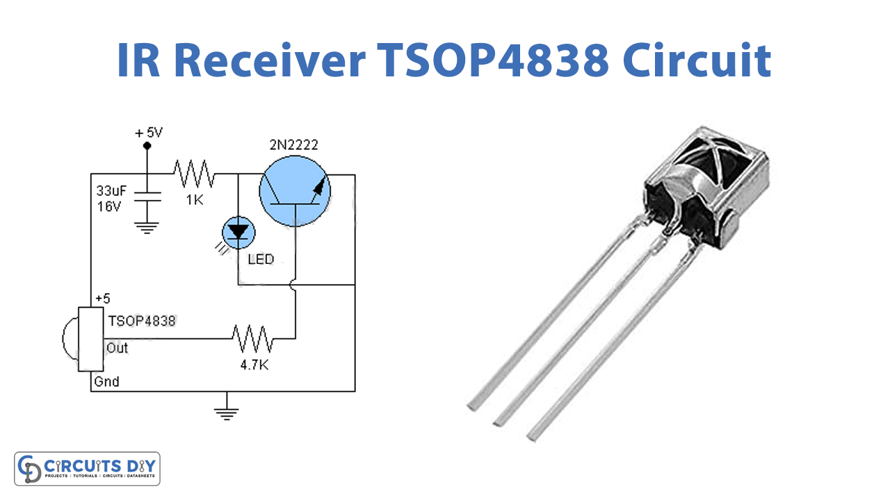

And I don't know If it makes a difference but im using this IR Receiver.

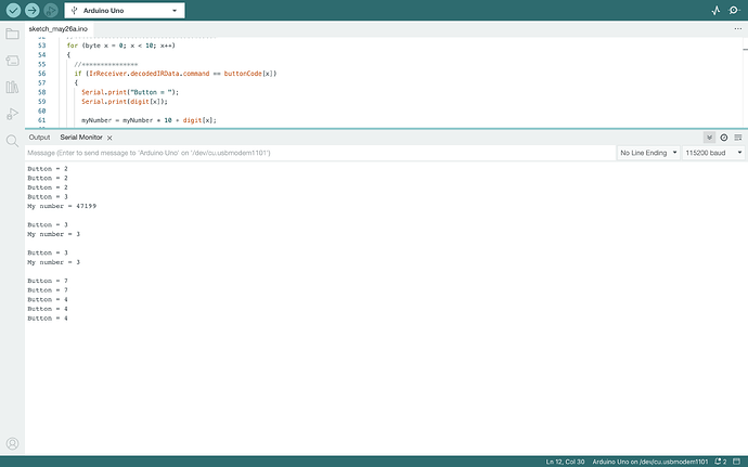

Alright I tried it and used button 3 for hash. But It still repeats 2 or three times. Take a look.
clicked on these buttons only one time, yet it appears as though I clicked multiple times.
ohhh that makes sense, but still, sometimes it doesn't repeat 3 times, sometimes It repeats it twice, sometimes it doesn't repeat it at all. What I think I need is just like a simple delay after each click, so it forgets about the other repetitions. Im not quite sure how to to do it though.
Hey, do you mean change the 74 to one of my buttons?
Try using a button that is not from 0 to 9 as the terminator button.
Try the decimal “ . “
Always attach your modified code, not pictures.
Some remotes send a key more than once, if yours does, you will need to to ignore the extra received numbers.
okay so I finally undertstand. I just need to change the code, so instead of multiplying my digit by 10, I do whatever I want to do. Let me try it out and get back to you.
If you use “ . “ as the terminator, to enter 123 the user presses 1 then 2 then 3 then the “ . “ key on the remote.
Okay so I got the "." thing to work. But Im still getting repeated numbers. Take a look.

      Serial.print("Button = ");
      Serial.print(digit[x]);
      myStringNumber += buttonCodeInString[x];
  myNumber = myStringNumber.toInt();
  Serial.println("");
  if (IrReceiver.decodedIRData.command == hash) {
    if (myNumber != 0) {
      Serial.print("My number = ");
      Serial.println(myNumber);
      Serial.println("");
      myNumber = 0;
      myStringNumber = "";
  //needed to block repeat codes
  IrReceiver.decodedIRData.command = 0;
}  //END of   checkIRcode()
