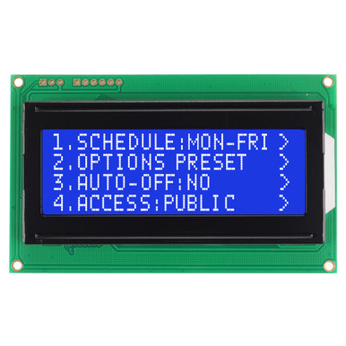

Hi everyone, I hope I'm posting this in the right place...
I have an Arduino Uno R3 and made a web controlled relay system using an Arduino ethernet shield and SainSmart 8 channel relay. It all works fine, but I also purchased a 20x4 LCD display that I would like to use (this one -> http://www.amazon.com/LCD-Module-Arduino-White-Blue/dp/B003B22UR0) and half of the pins the LCD needs to connect to on the Arduino are already used...The ethernet shield needs four, and my relay is taking up eight, and I'm guessing if I still connect to the pins using a breadboard it won't work because the code I have is already controlling those pins. What are my options?
I'm pretty new to Arduino, but it all seems pretty straightforward...maybe I'm missing something?
Thanks for any help!
-Ryan
Use a shift register. You can operate a char-lcd with 3 pins using a hc164, or 3/4 using a hc595.
Get one of these instead and use SPI interface. Share SCK/MISO/MOSI with the other devices, only need a chip select pin free.
Thanks! I think I'll try the shift register first, just to save money since I already have a display
If you still have pins 0 and 1 for USB serial support, in theory you could connect the phi-panel instead of the USB, and use the 20x4 terminal like you would the USB serial support. Most of the kits have the 20x4 screen, but one of them just has the just the PCB and the ATMEGA328P-PU loaded with firmware for $9 plus s/h. http://www.inmojo.com/store/liudr-arduino-and-physics-gadgets/item/serial-lcd-back-pack---phi-panel/
You can control it with only 2 pins using a shift register, 1 diode and 1 resistor.

I don't see what the problem is. The Arduino Uno has 20 I/O pins (D0-D13 and A0-A5), or 18 if you want to reserve pins 0 and 1 so that you can use the serial monitor. You are already using 4 for the Ethernet shield and 8 for the relay board. Your LCD needs 6, so that's 18 in total.
You can use ANY 6 pins (including the analog pins) to connect your LCD, you just need to declare which pins you are using in the code..
