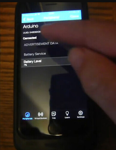

I have used the Battery Monitor Demonstration with LightBlue app for my Android and it works but its extremely weird.
When I connect I get a menu, something like this:
BatteryMonitor Connected
1B:8A:D9:D9:B6
Advertisement Data >
Services
Generic Access
Device Name >
Arduino
Appearance >
Properties Read
Generic Attribute
Services Changed >
Properties Indicate
Battery Service
Battery Levey >
Properties: Read, Notify

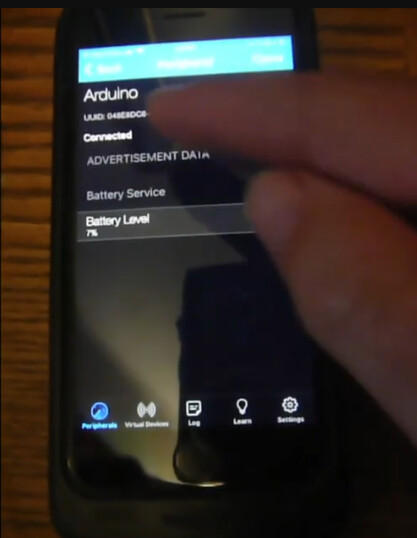

Of course the only thing I care about is the Battery Level. And when I select the > to the right of it, I get a whole bunch more useless information, all defaulted in hexadecimal. There is a read button that if I select, I finally get the information I was looking for but in hexadecimal. Selecting the "HEX" button to the above right gives me the data I' looking for in 8 different formats. 4 of those formats I never heard of but have the correct decimal value.
I found this video on YouTube, where the guy connects and the battery service is immediately displayed as soon as its connected as Battery Level 7% with not intermediate menus or need to select options.
Only difference I can see is he is using an I phone, I am using an Android
How do I get mine to come up and just say Battery Level with a decimal value.
Question #2. The literal strings "Battery Level" and "Battery Service" and not passed in the sample code at all. Yet they show up on both my Android and in the Sample picture below.
A sample of the picture and the full You Tube video are below. Unfortunately the video is closed to questions.
