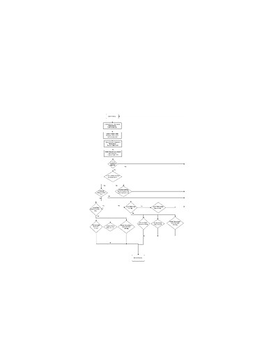

Using milli () delay instead of delay

in my code in each indicating led function i call i use a large delay which i think is messing up my system , i want to try to use the millis () function and see if that would help but im having trouble trying to implement it iinto my code
Look at File|Examples|02.Digital|BlinkWithoutDelay to use millis() for timing instead of delay().
#include <Animately.h>

if (tankLvlCM >= minwatertankLvl )
  lowWaterlevelnotify() ;
else if (rainfallVal > rainfallThreashhold{
  return ;
else if (soilMos1 > soilMoisturemin) {
  return ;
else if (tempC >= 4.4 && tempC < 21 &&  ) {
 waterpumplowtime();
else if ( tempC >= 21) {
  waterpumphightime();

im basically making an irrigation system , so when the measurements dont meet the conditions in the else if statements then it returns back to the start of void loop which is getting the measurements of the plants environment
ive also attached a flow chart to
I like flow charts.
I haven’t look closely at the sketch but if I were doing similar I would be using State Machines.
BTW
Avoid using delay( ) as it stops other code execution for this time period.
Also, while( ) loops can get you into trouble if they don’t have a way out.
