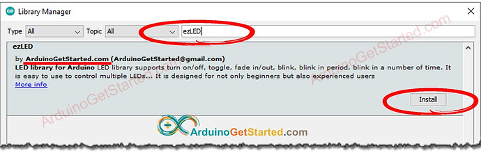

You can make it easy by using this led library.
#include <ezLED.h> // ezLED library
ezLED led(9);  // create a LED object that attach to pin 9
  led.blink(5000, 30000);         // 5sec ON, 30sec OFF
  led.loop(); // MUST call the led.loop() function in loop()
The library already used mills() inside. You do not need to care about timing.

However, library named ezLED.h is not found in the net. The led-main.zip file is included in the IDE and now the ezLED.h is recognized and the sketch works.
You can install via Library Manager on Arduino IDE like below:
