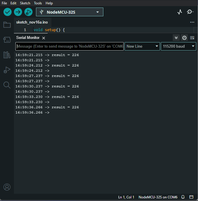

This is what I got from serial monitor:
I am not sure what else to do, I made sure the grounds to be common, I think I used the correct function code and slave address, but I still get result = 226. Im quite stuck right now, maybe I am missing something here, any help is appreciated right now, thank you very much.
Below is the datasheet of the RK330-01B for your reference:
226 is the error code that indicates a timeout whilst receiving a response from the sensor. Generally I take it that the sensor hasn't responded at all.

Hi, I am doing a very similar project where I am trying to get my RS485 sensor output to show moisture, temp, and PH but is has not been responding through my ESP32 and MAX3485A. Using your successful code in post #17 and just changing my TX,RX to match my pins 18 and 19, I am just getting "result = 226" on my serial or nothing back in my RX. Would you be able to help me too?
I even tried using a usb directly to my sensor and pc, then checking the .exe file that the company had for the sensor config to check if worked and got this so it should be responding.
GPIO18 -- RO
GPIO19 -- DI
GPIO4 -- RE and DE
3.3V to the MAX VCC
12V to sensor
Hi @levycake , I believe you cannot use pin 18 and pin 19 for serial communication. Unless you are using SoftwareSerial.h, which as far as I know, sometimes work and sometimes not. And it is recommended to use hardware serial for the ESP32 as you don't have to include additional library just to handle the serial communication.
