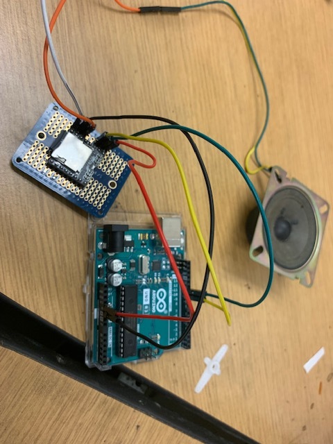

Sorry to bug you again. I was able to transfer the MP3 program you sent to my Uno board but unfortunately nothing is happening. I tried both Tx and Tr and 10 and 11 on the board.
I do have 5 vdc at the board so that's good.
Any ideas?
Thanks so much
Have You posted the schematics?
Trying different pins "at random" makes me think that some hardware uncertainty exist.
Tx/Rx? Likely. Mind sync the code and the wiring....
Read the comments in the beginning of the sketch.
It states what pins it uses
checked, checked and rechecked again. all pins are exactly where they should be. Different boards etc.
As I said, the audio card works perfectly without the arduino.
Gotta give up on this. Ive wired complicated circuits a million times successfully. This only requires 4 lousy wires.
I may have shown lack of knowledge and some ignorance with this project but im not that stupid.
And based on so many others past input in not having much better luck, apparently I'm not alone.
Thanks for your time.

Hope you can see how I wired it.
Thanks
better pic
IMG_2682

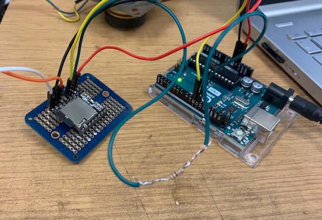

PE - A 1kΩ is resistor is needed between Uno Pin2 and MP3 Pin2.
If you don't ken that - then say so.
I did try your sketch. It uploads fine.
I did install a resistor before. Same results. Also because the audio card works beautifully without the Uno board or a 1K resistor, I didnt install one this time.
I will give it another go though.
Thank you.
IMG_2685
Added the 1k resistor.
I also loaded your sketch.
Sorry. except for a click when applying power its still dead.
Ugh
My sketch uses pins 2 and 3 (not 10 and 11) -- 2 goes to 2 and 3 goes to 3.
It also uses a different library (DFRobotDFPlayerMini.h)
