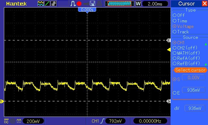

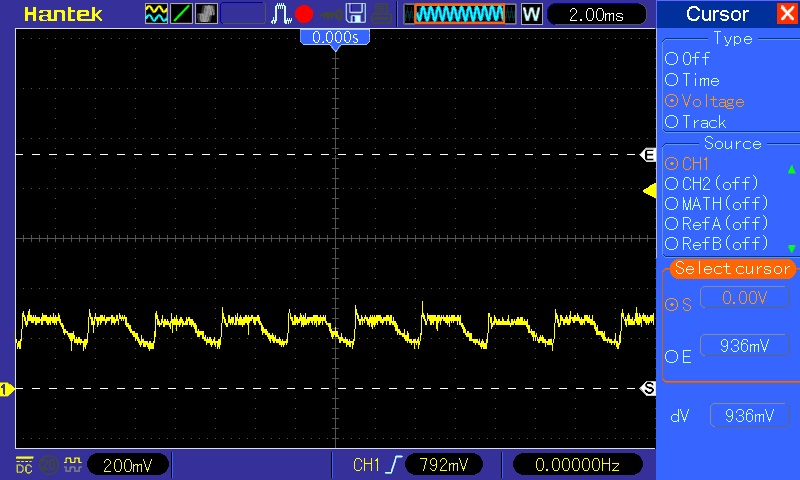

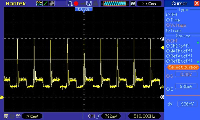

Does the 470uF capacitor help with the noise, or is it for smoother run of the LCD? Have you investigated further into the noise thing?
When I first used Nextion displays I noticed they were interfering with things. Most notable I had a GPS receiver that would only work if I put it a long way from the Nextion. I put a 1 Ohm resistor in series with the supply and used it to monitor the current with an oscilloscope, you can see the result below. As this is measured across a 1 Ohm resistor the peak of the spikes is about 930mA. The second image is the exact same set up but with a 470μF capacitor soldered across the connector on the Nextion. 470μF was the smallest value capacitor that completely eliminated the spikes.
