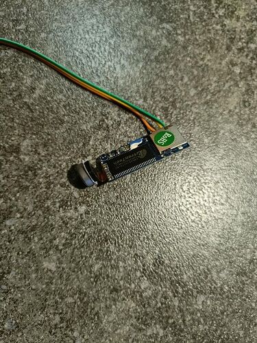

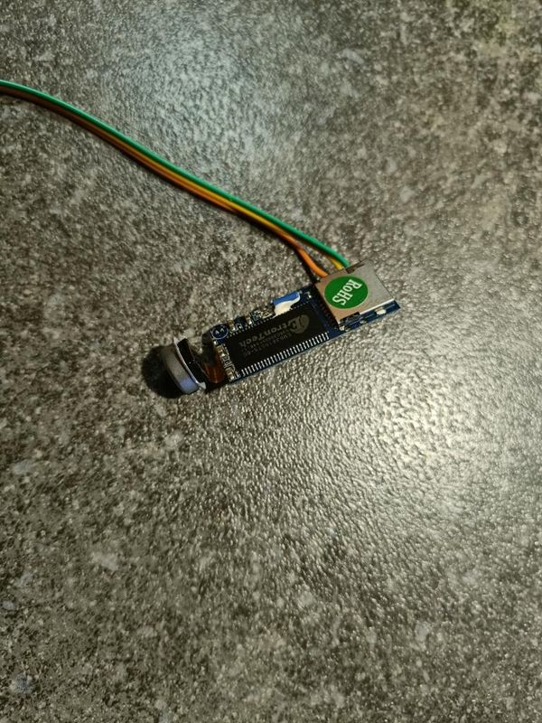

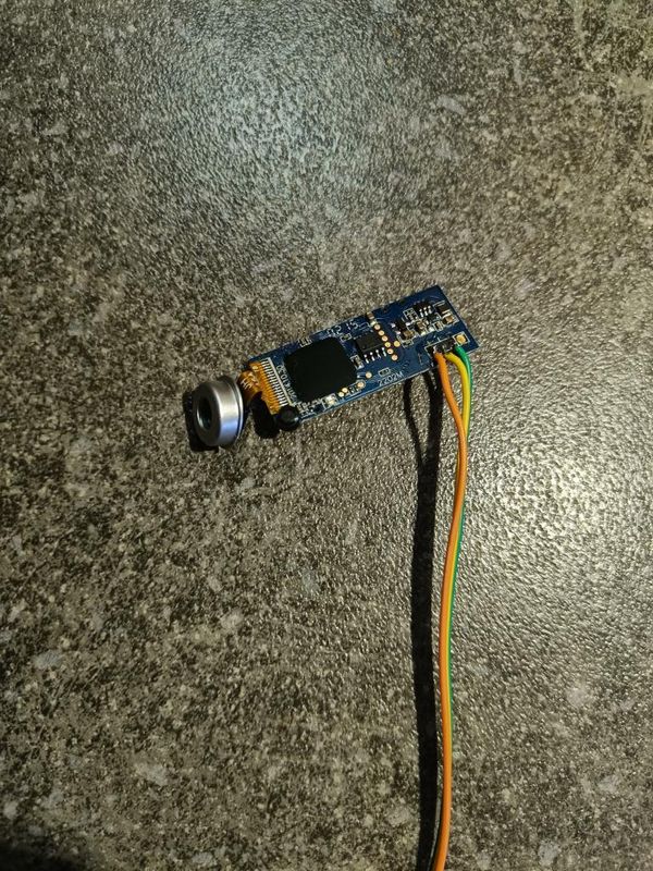

Hi, I have a camera from my old drone with a spi sd card module attached. I have to connect the green wire to the ground for less than 1 second to take a picture, and more than 1 second to start and stop the video. Is it possible to connect the green wire for example to pin 7 on the uno and use digitalWrite(7, LOW) to control the camera? But what state should I put pin 7 in after connecting to ground? Wouldn't digitalWrite(7, HIGH) damage the camera module?

I'm not sure, because there is a step up converter and a transistor on the board, but I power the whole board with 5v.

I was thinking about something like this.
#define cam 7
  pinMode(cam, OUTPUT);
  digitalWrite(cam, LOW);
  delay(500); // to take a picture
  digitalWrite(cam, HIGH);
Safer:
#define cam 7
  pinMode(cam,INPUT);
For this to work, the camera power supply voltage must not exceed the Arduino Vcc, and the camera current draw should not exceed about 20 mA.
