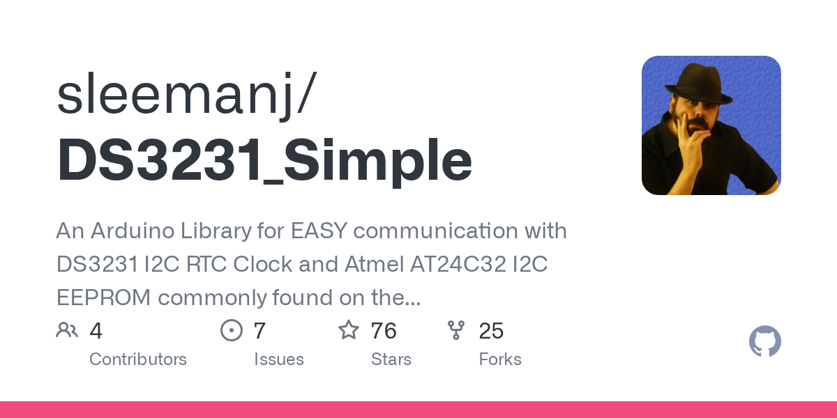

I have found this library for my RTC DS3231 device and I like it very much except I would like to the output of the Print... functions to be returned as a string instead of being printed in Serial stream
Is there a way to declare a String variable as a Stream and use it in those calls or a way to declare a Stream variable and then convert that to a string/char[] buffer.
The data in the end will be either displayed on a UTFT controlled LCD screen and/or transmitted via Ethernet shield hence the need to it to be stored in a local variable of sorts.
I know I could fork the library and convert the functions to return the string instead, but I'd like to see if I can avoid this first.
