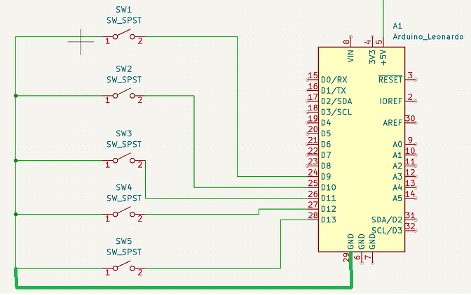

Looking for some help with a weird issue I have. I'm trying to create a button box that uses SPST switches to act as a toggle for a keystroke but want they keystroke to register once for every time the switch changes position (keystroke when switched to on and keystroke when switched to off). What i have works perfect for use with pin 13 but any of the other pins i use, seems to just loop through and print keystrokes randomly. Additionally, i have these switches mounted to a steel plate and oddly enough i can start and stop the printing by just resting my finger on the steel plate. None of the wires are touching the steel plate nor is the arduino which is mounted on the plate using double sided tape on the clear plastic mount that came with the Leonardo board.

What, if anything, is keeping your switch pins at a known state at all times, or are they floating at an unknown state , maybe HIGH, maybe LOW, when the buttons are not pressed ?
Consider changing their pinMode() to INPUT_PULLUP to activate the built in pullup resistor to keep them normally HIGH. Change wiring to take the pins LOW when the button is pressed and adjust the program logic to match

You also missed to tell us how you connected the SPST switches: based on your code, you must have a pull-down resistor (typically 10k from the pin to GND). If not, that's why you get strange behaviours, you always either need to have a pull-down or a pull-up resistor. And with the latter, you must remember the switch off is read as HIGH not LOW (you could avoid the external resistor by declating the pin as INPUT_PULLUP not just INPUT).

Your input pins are floating, despite the fact that you used INPUT_PULLUP mode. Please post a link to the data sheet of the switches you are using and a schematic to show how they are wired to the Leonardo.

Here’s a schematic that shows just the toggle switches. I’m not using external 5v power like this shows though.

Here is updated schematic for just the toggle switches.
Thanks for the link.
What would you expect the input pins to read when the switches are closed?
What would you expect the input pins to read when the switches are open? Remember that your code sets the pins to INPUT_PULLUP mode.
The correct answer to both questions is HIGH. That means your code won't be able to tell what position the switches are in by reading the input pins. They would never read LOW at all.
That's assuming your schematic is correct.
But your description of the problem tells us the pins are reading HIGH and LOW at random, influenced by nearby objects. They are floating.
In reality, they can't be connected as shown in your schematic.

D9 - D13 → change to INPUT_PULLUP

Won’t this create a short?
All the switches are open. When you press a switch, GND is applied to the pin. That creates a good "short" (because the pin reads LOW)
INPUT_PULLUP is 5V through 20K to 50K ohms. A very limited short.

I'm sorry, but I don't understand: how does that section might give a short between +5V and GND?
There's R4, so while the button is pressed you have a 10k Ohm resistor between +5V and GND, so inside that link flows a current I=V/R=5/10.000=0.5 mA.
Why on Earth would that be a problem?
