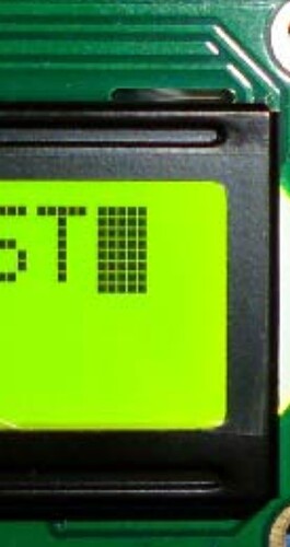

3 bits from each byte are unused, but only 5 are needed.
So the only thing going on here is that the programmer is being terse? I was thinking in terms of all bits being defined, but I guess the implication is that characters on one of the 16x2 LCDs is comprised of a matrix of pixels that are (rowxcol) = 8x5 in size?

Yes, take a look at this close up image of a block with all pixels set:
It is 5x8 pixels.
