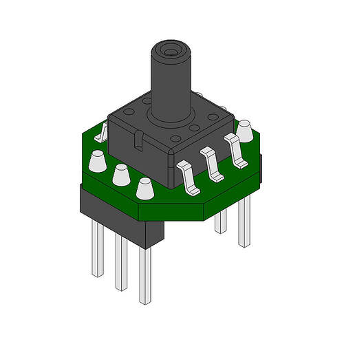

I am looking for help regarding sourcing a sensor to read up to -25 InHg of vacuum. Can anyone recommend such a sensor, and what else am I likely to need?
Thanks in advance

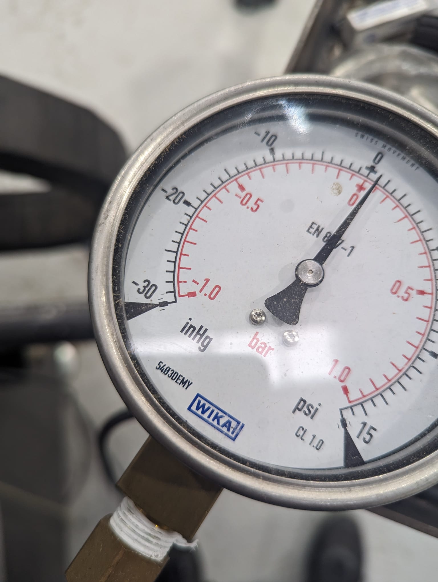

The gauge is attached to an industrial vacuum pump. If the valve is closed the gauge looks as it does in the photo, ie 0 InHg. Then the valve is open and the vacuum is drawing against an object, it measures around -20 InHg (-0.7 Bar)

If the pin of this gauge is at 0.00 bar = 0.00 inHg this means there is no pressure difference between environment and whatever the gauge is connected to.
If the pin of this gauge is at -20 InHg (= -0.7 bar) the meaning is the absolute pressure inside is +0,3 bar which is 0,7 bar below the absolute pressure of the environment which has 1.0 bar absolute pressure.
So this means you are searching for a pressure sensor that can measure a differential pressure in the range of -0,8 bar to + 0.8 bar
minus 100 kPa means absolute vacuum. 1 bar below 1 bar environmental pressure
