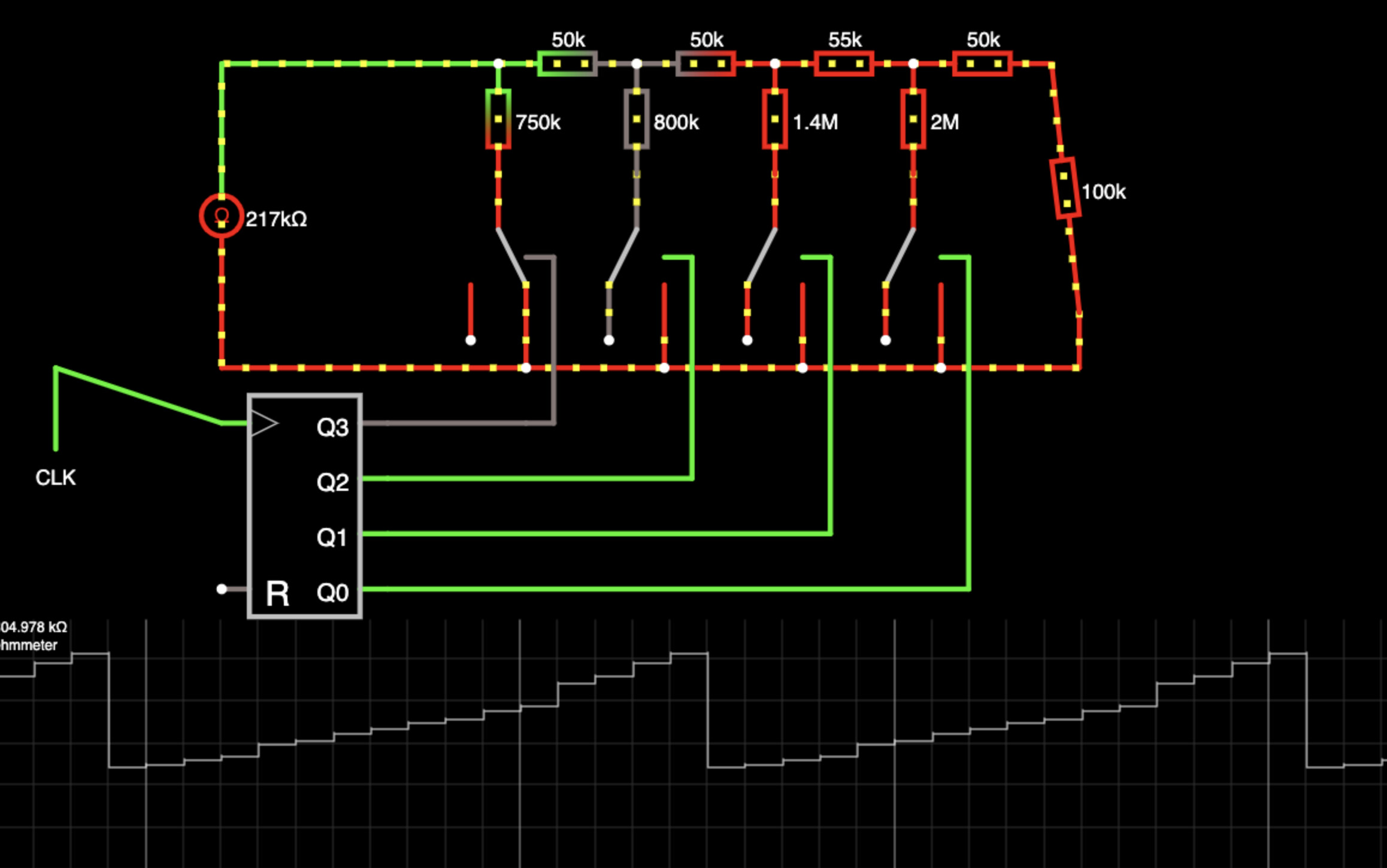

Hi , I'm working on a project to create a charger for a large array of lead acid batteries, so it needs a very high current output.
I've got the main components working, but manually have to adjust the output voltage , so I'd like to control this from the arduino.
I've built a 4000W PSU @ 48V , and have bought one of these variable boost converters :-
It has a 200K pot at the output which allows you to adjust the boost voltage.
I thought I'd just replace this with an SPI / I2C digital pot , but then after de-soldering the pot I discovered (the hard way) that it's actually putting AC through the pot. :o
So , now I'm a bit stuck. The specs I read for the MCP digital pots sound like they only like DC across the A/B pins , and it needs to be within 0.3 V of VCC , so that's scuppered that plan, so now it looks like I'm going to have to build some kind or R-2R ladder to act as a pot ...4 bits would be enough a 16 stage charger will be plenty of flexibility.
Any ideas for circuits ? I presume I'll need a 4 channel SSR , but was wondering if anyone had any other suggestions / knew how these boost converters operate, or were already controlling the boost voltage another way ? Any suggestions welcome.

Thanks for the reply Perry , think you missed the point of the boost converter, the PSU only puts out 48V .... the boost converter ups this to 57V6 , initially 2V4 per cell, and can limit the current, but then decreases to 2V3 per cell as the battery approaches full charge, then 2V2 float.... but ignore all that ... the charger works well , it's just a pain having to adjust the voltage manually as the batteries charge.
I should've just asked "How do I replace a 200K 0.5W POT with AC across it with a digitally controlled equivalent"

4000W at 48V implies a current of over 83A, does that boost converter you linked to have the ability to supply >83A? It doesn't look like it to me!
As to a stepped resistor ladder, how about reed relays as they will provide isolation.

Damn... just realised that if I use a resistor tree / ladder and I want to vary between 57V6 and 52V8 I'm probably talking about only a couple of turns of a 28 turn pot .... I also wanted to make it 'optionally' work at 36V and 24V .... so I think I'd best go stick it in a breadboard and take some measurements.... if I can work out the resistance change to cover a 5V swing I can just swap in an upper and lower resistance and just have my "digi-pot" in the middle (the 4KW PSU can output 48/36/24/12).
wonder if there's such a thing as an IC resistor tree.
Yes - lookup resistor network on Google

I took the POT off last night and it's putting 70VAC across that little trimmer pot !
I got as far as figuring out that one end of the pot is shorted to the wiper, the voltage is controlled by the R between the wiper and the other end, and to get 57V out this R needs to be ~65K
I then shorted the whole thing with a clumsy probe and blew the bloody fuses.
Ordered some of amazon ... should be here by Friday ... hopefully it hasn't damaged anything else.
Apologies for my ignorance, it's 25 years since I did electronics and the memory is not what it used to be.
Problem with the resistor network IC's is they're either the same values or R-2R. I could create a binary tree , but to get a simple 4 bit tree would require 15 switches/relays/SSR's
Using the same pattern as R-2R I can do a 4 bit resistor network with just 4 SSR's. I've attached a screenshot of a simulation of what I'm trying to do
Can someone tell me what formula I'm looking for here to work out these resistor values. It's a resistor ladder like an R-2R, but instead of voltage stepping linearly, I want the resistance to step up linearly... in my ignorance I've tried tweaking the resistor values manually and got it close-ish (the graph at the bottom is Resistance across the network) , but it'd be nice to do it right.
In case it helps anyone else, I got this working, and in a moment of clarity realised I didn't need a ladder network to achieve the digital pot, The attached circuit creates a perfect linear digitally controlled pot.
