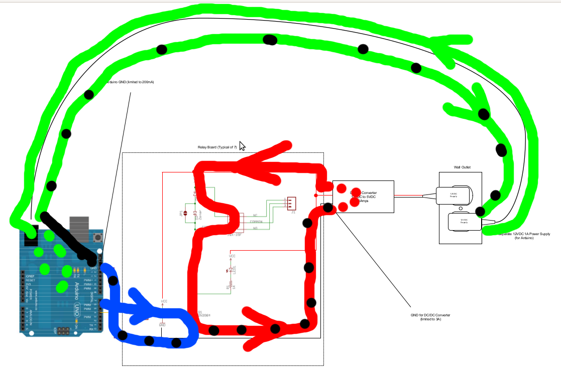

Essentially I am trying to make a "smart surge protector". I have 7 outlets controlled each by their own relay. Each relay coil draws 185mA making a total current draw of 1295mA but only have the 800mA available on the board. In addition I have 3 dosing pumps which draw 300mA each from thier own external 12V power supply connected to an arduino relay shield, however only one will be powered at a time. Also need to account for the current sent to the sensors and LCD which determine each outlets status. Is there anyway to accommodate roughly 1.8A of control for this type of system? I am powering the Arduino via a 12VDC source and the pumps on their own 12VDC power supply/

The schematic for the relay board is attached below. As seen, the power is provided by VCC (5V) however the relay spec sheet allows for use with 12V (see attached). Can I simply just use 12VDC from an external power supply in place of the VCC 5V without having to replace the other board components? If so, would the GND at the bottom of the schematic be connected to the negative wire on the DC power supply in place of the Arduino GND?

Attached is a PDF of a wiring diagram I just made for the circuit. I tied the Arduino GND to the GND of the DC/DC converter as indicated by a purple wire. Is this what you were suggesting? If so, is there a way to route the majority of the grounding current to the DC/DC converter ground (rated at 3A) rather than the Arduino GND (rated at 200mA)? I was thinking that there may be some way to select the current sink path with a diode but was not totally sure.

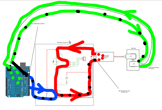

The wiring in the picture is good.
I have attached a picture with the current paths.
Green : the current for the Arduino, perhaps 50mA.
Blue : the current of the control signal, perhaps 1mA.
Red : the current through the relay(s), total about 1A.
The black dots are the grounds and they are all connected, that’s good.
Is it possible that the current in the red path could take the ground path of the green one (via blue) ? No, that is not possible.
If you would have used a single 12V power supply, then it would be possible and you would need to connect them in a different way. For example a star-ground.
As it is now, the GND pin of the Arduino has only the 1mA of the control signal.
