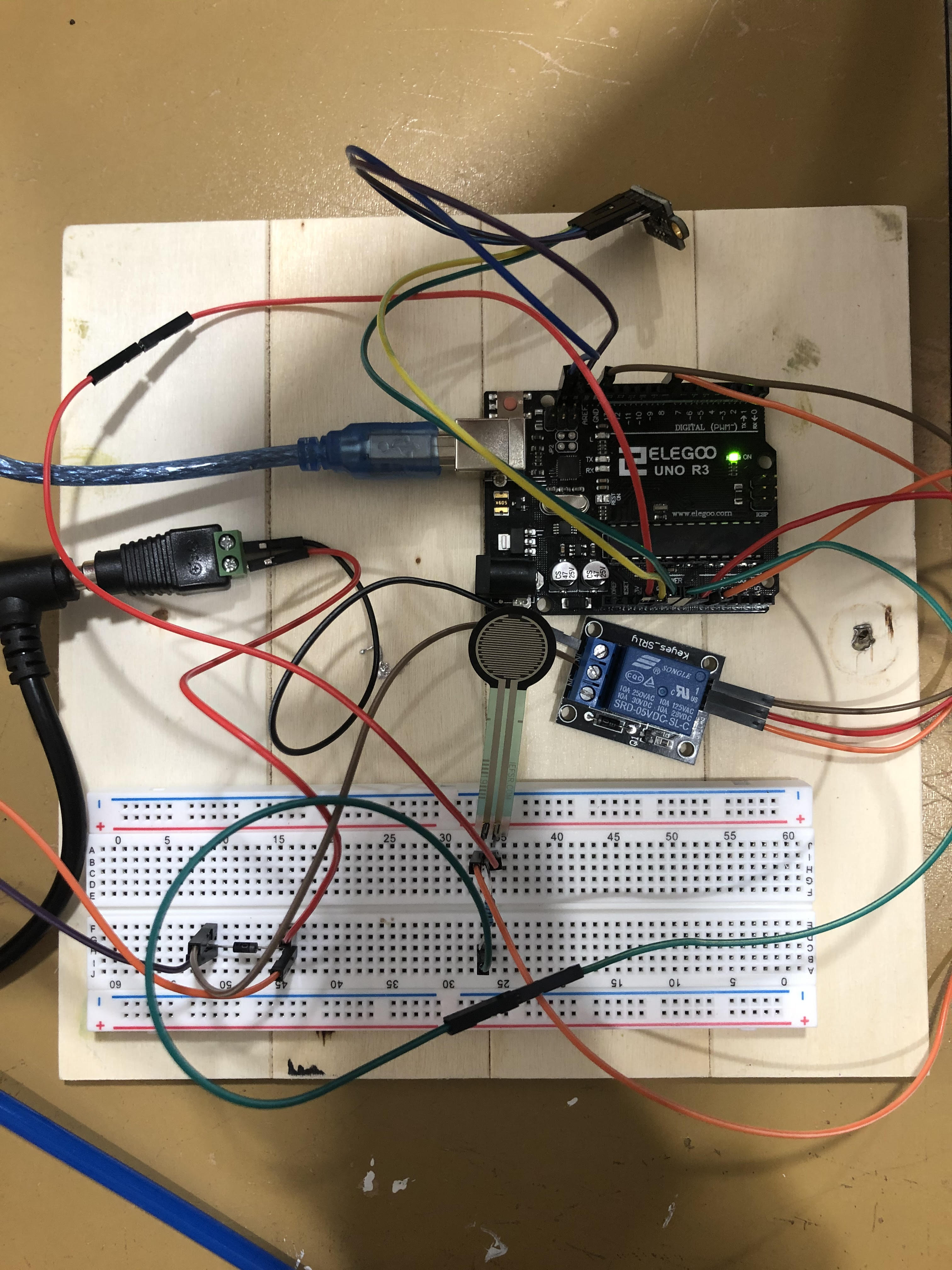

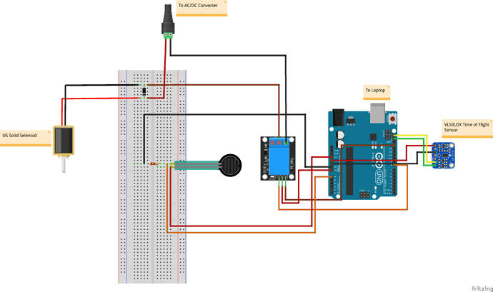

Hello,
I am a newbie. I am trying to create a pneumatic fatigue tester for soft materials. I have an air-driven pneumatic cylinder connected to a solenoid (via a 5V relay switch). As the pneumatic cylinder compresses the sample, I want to measure force using a force-sensing resistor (FSR) and I want to also measure the displacement of the compression using a Time of Fight VL53L0X laser sensor. I send all data through the serial port to a python program that saves the data. My goal is to have different frequencies of loading with the fastest at a delay of 0.1 s. I'm using baud rate of 115200.
Most everything is working perfectly in pieces, but when I have everything (5V relay switch going on and off, FSR collecting data and ToF sensor reading data) my code runs slow (takes about 1 second to advance to the next step)
When I comment out the ToF reading, it goes back to running fast (a delay about .1 s).
My thought is that is something to do with sending information from ToF back to the serial port but I have not able to find others with this problem. Without the ToF sensor, the FSR and relay switch works perfectly. I can control the delay from my python program and data is saved to a file just fine (I don't think there is an issue sending and writing data). In fact, at this point, I am not even sending ToF data back to the computer. It should just read and not do anything with the reading.
Below are details including the wiring diagram, my Arduino code, and my python file. I have also included a picture of my setup.
Any suggestions about why the slow down might be happening would be very helpful. Thank you.
Wiring diagram:

Picture of setup:

If You attache the code using code tags, upper left symbol in this window, and made the pictures show up here as well Your post would get top marks.
Several helpers can't download and read. ino files.
Are there Serial, or other prinouts in that ToF code?
rhk12:
No need for searching, Serial output is a bottleneck in every program. Reduce the output and increase the baudrate for better overall performance.
Welcome to the forum.
Please read the post at the start of any forum , entitled "How to use this Forum".
OR
http://forum.arduino.cc/index.php/topic,148850.0.html.
Then look down to item #7 about how to post your code.
Thank you all for your responses. I have updated my posted to include images and code. I did get an error that my posted exceeded the limit when I added my python code, so I am including that here. I also left the pdf of the code attached.

I checked the ToF sensor output with the V53L0X and also had the FSR hooked up. I think I made a separate Arduino.ino file to check these. I know that both of them were printing accurate results to the serial monitor very fast (~.1 sec).

I also include a diagram of the circuit in the update.
Thank you for any suggestions you might have.
Reuben
