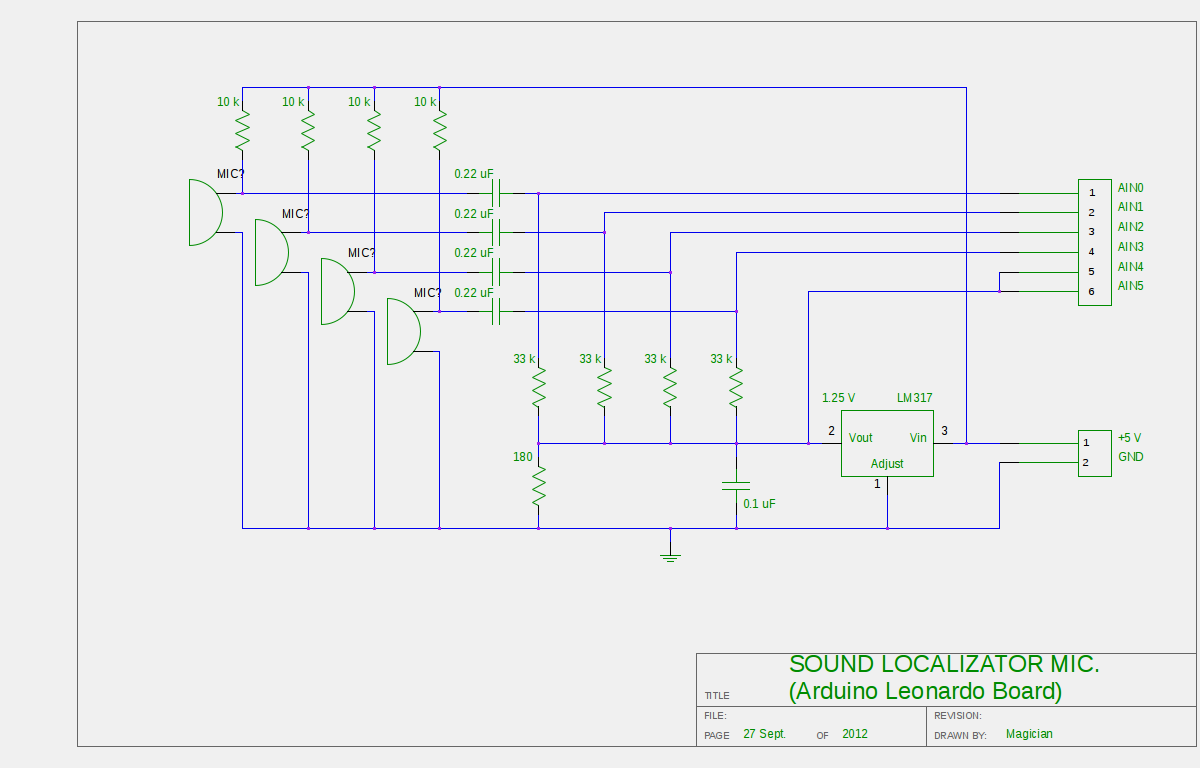

I did it, with UNO and Leonardo. Mic + preamplifier ( gain 100 - 250) + arduino. In case of Leonardo, you don't need an amplifier, internal PGA works beautifully well with a regular condenser mic.
Having 2k memory, UNO capable to store 1 sec. audio track, compressed output of the FFT, than store to EEPROM or run cross-correlation with already saved track. 1 word only w/o external SD cards or other storage. Voice recognition.
Speech is "deteriorated" version of voice recog., so more compression could be done to store ~10 words in arduino itself.
There is a web-archive of the project, original post is lost:

You need only 1 mic, this drawings from another project "sound localization".

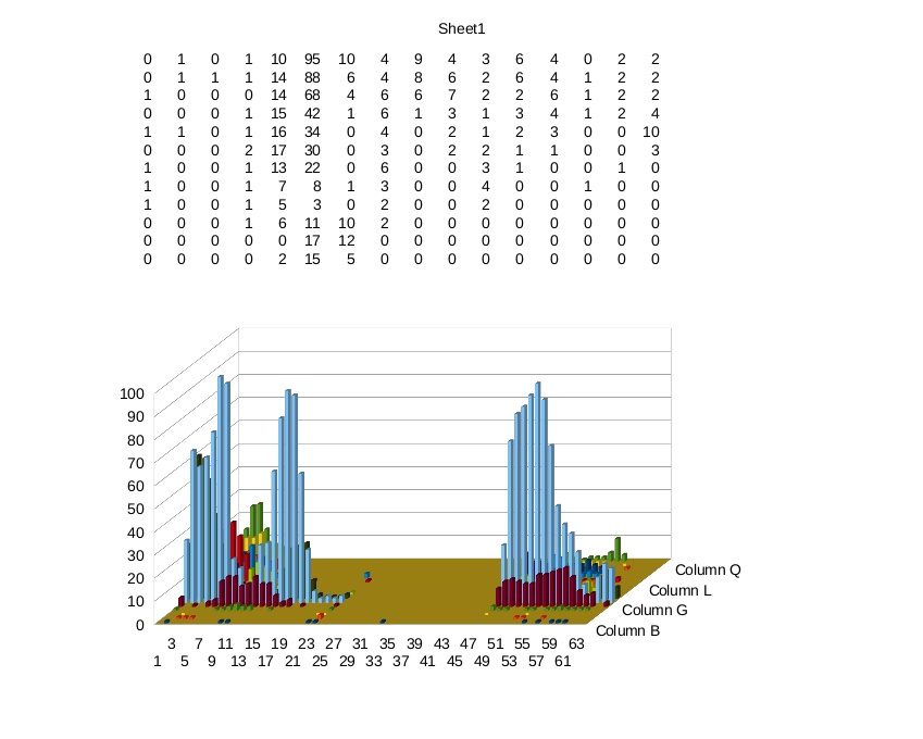

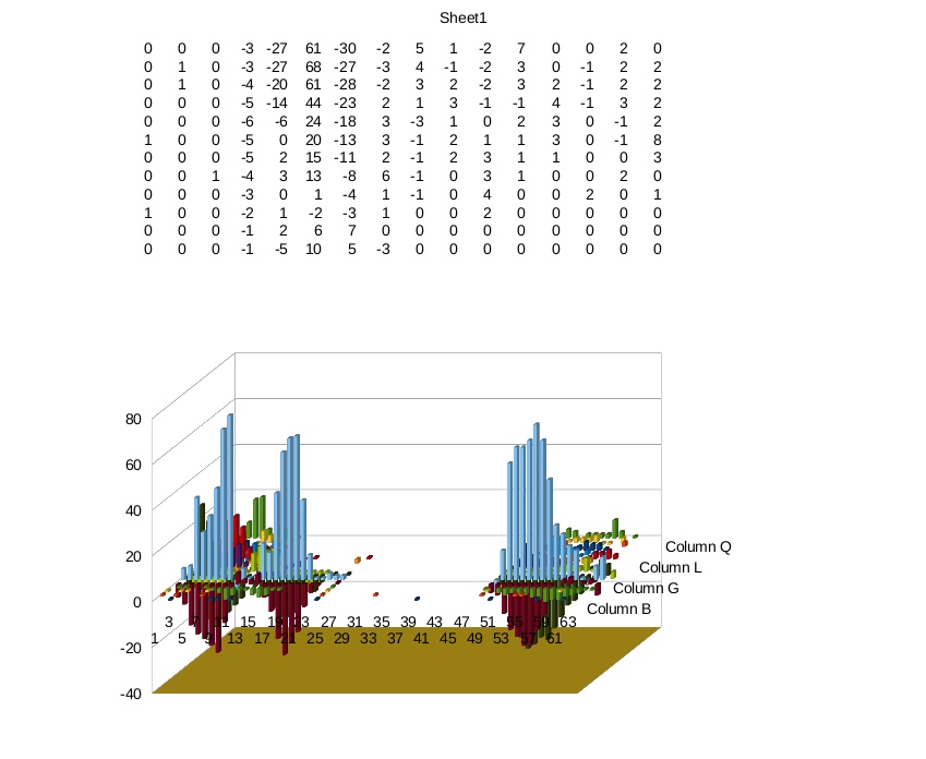

AFAIR, spectrogram is what my laptop says "test left" - linux ubuntu OS test speaker phrase
