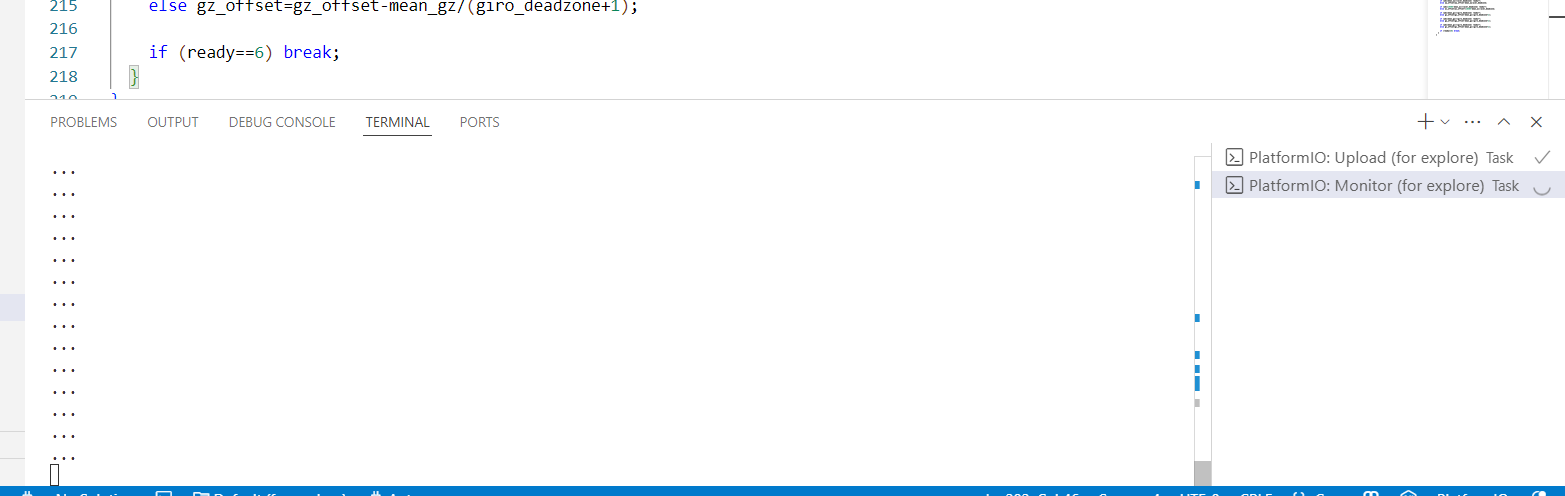

i wanna ask if somebody have tried to calibrate mpu6050 module using the same library from Jeff Rowberg? does the process take a long time? cause the program still calculate the offset (it's been like 5 minutes and still go on as i type this)
You can use the Wokwi link (post #7) to check if it takes longer in your environment than in the emulation. Usually Wokwi is quite close to the "real thing" ...

thank so much for ur advice, well silly me, i forgot that I change the MPU6050 i2c address to 0x69, now i get my offset value, thank u so much
Don't worry, things happen ...
